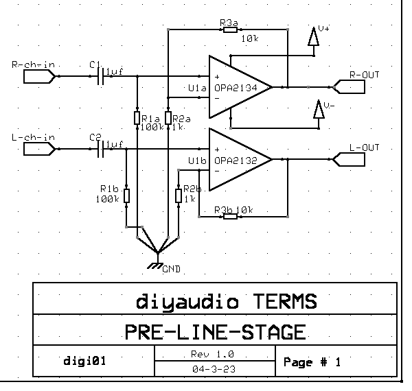

Supplement PRE-line sch again,I use a pair of 15v batteries to supply power.

Digi,
Thanks for the schematic. I'm going to investigate all the options for the preamp here, and your schematic looks a bit easier to handle.
I have to admit that I am attracted to the link to the preamp that matjans posted, so I may give that a whirl.
Where did you get your design? Did you design this yourself?
