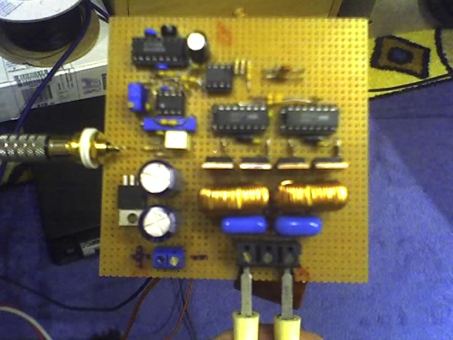

Hi nitrate, new breadboard?
Yeah! it seems a good project for home use...
nitrate said:
300KHz, 35V RMS output for 75W into 8R / 150 into 4R
Lol,
Yeh.. new breadboard amp..... got proto up and running, just need to clear up some whisleing noises in the background ( sounds like RF ) may have to take it off the bread board, might plump for some veroboard LOL. I'll post some schematics and photos n stuff as soon as i work out my protection circuitry.... This is one amp i'm determined to make bomb proof. In fact just stop it from destroying the outputs like my previous amps did would be a vast improvment LOL. So far so good tho.... no casualties yet

I knew i'd get comments about those 4148 diodes, i had a party last night, me and a few mates came back to my place after pub closing hours and we played music till 4am the next day. The amp was flat out all that time but the 4148's survived! bless them
Anyway just to put your minds at rest i'm gonna replace them now with some ultrafast high current diodes, namely MUR460RL. I have a a pack of these laying around and they should be ideal.
Some have noticed my feedback coming after the filter, this i have chosen to do to help eliminate the dodgeyness of the filter, it also helps to keep emf pulses out of the error amp stage. Belive me or not on this design the sound is much better this way, if i try taking the feedback from the bridge the high notes sound 'scratchy' and the scope shows high frequency interferenc on the output waveform. Maybe if i sort my inductor there will be less energy kicking around to cause this interference. Either way i like the idea of total global feedback, not just a shortcut from the bridge.
P channel fets are rare to say the least and changing my design to an all N channel is a wise move. I don't like the idea of bootstraping to create yet anougher power supply to drive the top fet, but i know its the right way to go, should mean i can use almost any high speed fet in the design.... i've already got hold of suitable driver chips from National Semis. Feels like i'm relying too on chip solutions though if i go down that route... Hmmm Besides i like maxim products because of their gaurantee of non obsolesence!
Somebody asked how i came up with the design, well i got reading this forum one day at work and i decided that i wanted to try class D for myself. I looked up on the net a description of class D amps so i knew what made them tick, then just sat down with a lump of breadboard and a scope and literally built one. I'm an electronic design engineer you see so thats what i do for a living, just sit down and build prototypes for to answer customers problems. Anyway i started by building a 275KHz clock. Origanally i used a 4093 i.c but the cmos familly aint fast enough. It ticked o.k but the square was not very square on the scope so i was forced to use high speed TTL family ( 74*** ) This also required the addition of a 5v supply. After the clock i added the next stage, the triangle. Easily done by way of anougher gate to buffer the clock then charge/discharge a cap from the output of the gate. I went to great lengths tweaking the values of the cap/resistor in order to obtain the purest triangle i could. When i was satified with the wave i then added the comparater, and a variable voltage divider. If all is well i should be getting a 50% pwm wave out the comparater. This checked out o.k so i decided to try sticking that into a p/n fet bridge across a 5v supply. This worked well so i tried stuffing a simple filter on the output ( actually the one i still use ) and hook up a speaker just to see what it sounded like. It was supprisingly good. I was using tiny e-line package fets to test it. After a succesfull test run i went to a bigger supply ( 12v ) and created a level shift circuit on the high side. This worked but the fets were getting quite hot even at idle. I found the drive was starting to get sloppy, Square was no longer square from the comparater so i tried squareing it up by buffering with anougher logic gate. This worked a bit but it eventually blew the logic. This is when i decided to use the maxim driver. Things were back up and running, but the fets were still a little warm. I just thought this was down to the small fets. Continued on next post....
