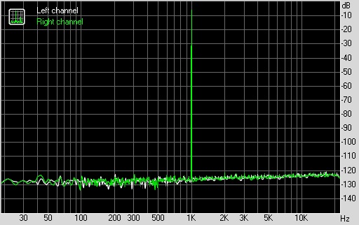

In case you haven't seen this yet: both Bruno and Jan had pointed out that Bruno's design 'in real life' offers excellent measured performance.
Hans Polak in his article 'An alternative Volume Controller for the Bruno Putzeys balanced Pre Amp' in Linear Audio shows the output spectrum of a 1kHz 1V signal in 0dB gain mode:
This measured unit by the way was built with Hans' alternative voltage controller PCB as featured in his article, so I consider my former concerns that it could have an effect on performance of the original design to be pretty pointless.
Many thanks to Hans and Jan!
Robert
As Hans so aptly put it: 'This preamp refuses to distort';-)
