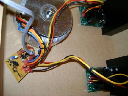

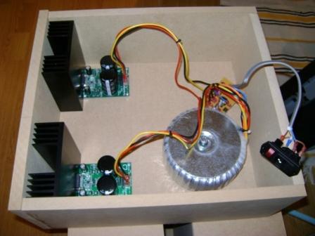

below are some pictures of a Sympatico amp I am building for my father.

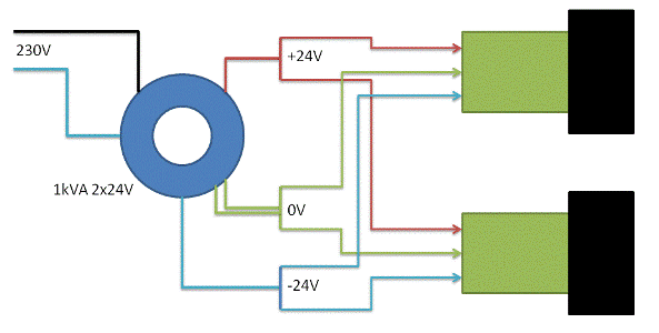

I have used one 1000VA 2x25V transformer to power 2 channel
you can see a little circuit i put together to distribute the +24V, 0V and -24V rails to each amp & also included a thermistor for trafo mains & earth
box is simple MDF panels glued together, perspex top panel will follow and nice gloss finish will be applied
