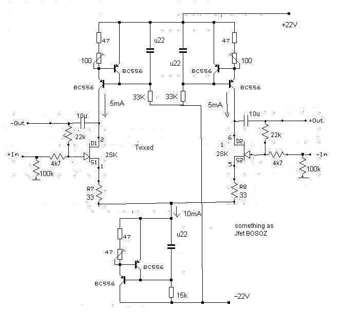

Juma's BF862 pre isn't intended for driving buffer amp .
Juma can make preamp which will make your speakers bleed ........ but this one isn't of that sort ;)
Skorpio - there is ( somewhere ) thread named BOSOZ for F4 or something like that
if I remember well - result is jfet based cascoded differential stage ........ that thread later results in funny :Pumpkin: development

That SSTART amplifier looks nice, just like a BoZ with a big JFET in the source. Makes me wonder...could one of the new power JFETs make it as alternative for the MOSFET in the BoZ?
I like the idea of plenty of current and low drain resistor, lots of drive and 20dB gain for F4, but will a power JFET do the job here? Mr. Pass wrote in the original BoZ and BosoZ articles that he had tried power MOSFET with acceptable results (high gate cap increase HF distorsion)...so it might på doable. The easy bias will be attractive, nice and simple :)
