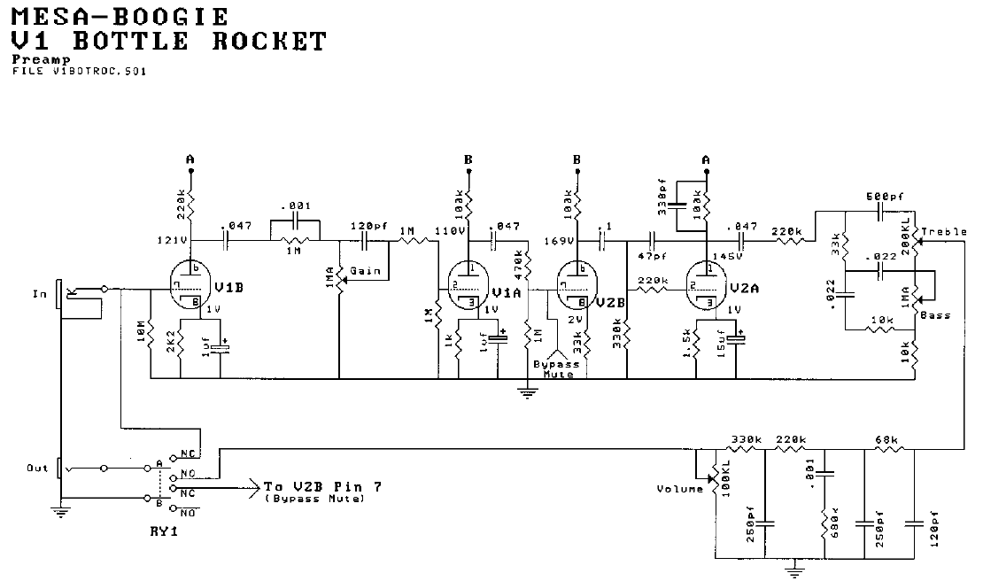

hello! i need help with this tube pedal concerning output, midrange and clipping
i've picked up a Bottle Rocket pedal, made by Mesa;
it's cool, but lacks midrange and headroom.
i need help to fix the loss in tone stack and maybe reduce the clipping.
theres two places in the PCB with slots to install potentiometers: one for mid (20k), other for presence adjustment (1m)
i've tried these, there was a slight difference, but i've felt there was a faint loss in the output, tried with suggested values and diff. values too... no good
also tried diming to 0 bass + treble to achieve a mid tone, but this approach also resulted in loss of output rather than resolving my need
maybe we should start by lifting the tonestack to full bypass it with raw signal?

Change the first plate resistor from 220k to 100k. Short across the 220k resistor before the tone stack. Use a 50k pot for midrange. After that bypass the tone sucking, I mean shaping network to the volume pot. Use a 1M pot connected to the treble wiper as per normal resistive divider operation. Should have more control on the midrange, don't forget you can turn down the bass and treble to get more mids. At least that is what I would try first.

I forgot, when replacing the first stage plate resistor a 1.5k for the cathode probably should go with it. As far as I see the first stage should clean things up a little and without tweaking the whole mess the two big losses are the 220k before the tone stack and the network afterwards.
Just for giggles, you could try using the 100k volume off the treble pot, you loose 6 dB of signal as compared to a 1M pot but you can see if the network is loosing you a lot. Heck, just short the pre-eq 220k and take the volume pot off the treble pot. Cost you nothing and might make a reasonable improvement.

Drop the cathode bypass capacitor size to move the bass cut off point up.
Remove the "bright" caps.
Bypass the tone control and post-tone control cruft completely. Or replace them with a Baxandall which can actually give mid boost.
The tone stack is passive, meaning there will be interaction between the controls, and there will be a substantial signal attenuation, which is desirable if you want the output of the pedal to be approximately unity gain. I'd definitely add the midrange pot, and experiment with reducing the 220K R feeding the tone stack. If you want more headroom you might try removing the cathode bypass caps in the early stages and/or reducing the 33K R on the cathode of V2B to maybe half that (or less), to get that tube further away from cutoff distortion. If you're still not happy with the FR, you could mess with the multi-section EQ filter that drives the output level control.

*i see each ecc83 has 2 cathodes, 2 plates, etc.
so, lowering the first plate resistor is the 220k R from pin 6
the following cathode resistor to be working with the first plate resistor pin 6 is the first cathode known as pin 8, is this right?
*the cathode bypass capacitor, is originally which value?
and its linked to which pinout and which one of the tubes, or both v1+v2 benefit from this change?
the bass cutoff point being moved up by decreasing the capacitor value means less bass and more mid?
*the 220k resistor before the tone stack is the one inbetween a .047 cap and a 33k resistor with 500pf cap?
is this 200k resistor the so claimed 'slope resistor'?
can i pigback a wire on the start and end of this resistor to short it without removing/lifting one side of this resistor?
if the answer above is 'yes' will there be any resistor noise regarding this 220k been left intact just shorted, or is it better to remove it to achieve hum/noise audible reduction?

Yes you got it.

I would leave them be for now, keep the changes simple at first. You will get more bass by increasing the values, less by decreasing. You already are dropping bass with the given values.

No, the 33k is the slope resistor. All the 220k resistor really does is reduce the signal.

Yes, nice mod, just hook a wire around the two ends, no soldering needed. And if the wire is insulated and you are careful you can give one end a tug and hear how much gain it drops. No noise added by leaving it, the preamp will not know it is still in place.

Yes, I never thought of doing that. You could get a 1M trimmer epoxy it on the board and wire it in place of the bass pot then use a midrange pot in the bass hole. That way you can open it up and adjust the bass if need be.

Yes. I doubt you would want the mid pot more than 50k.

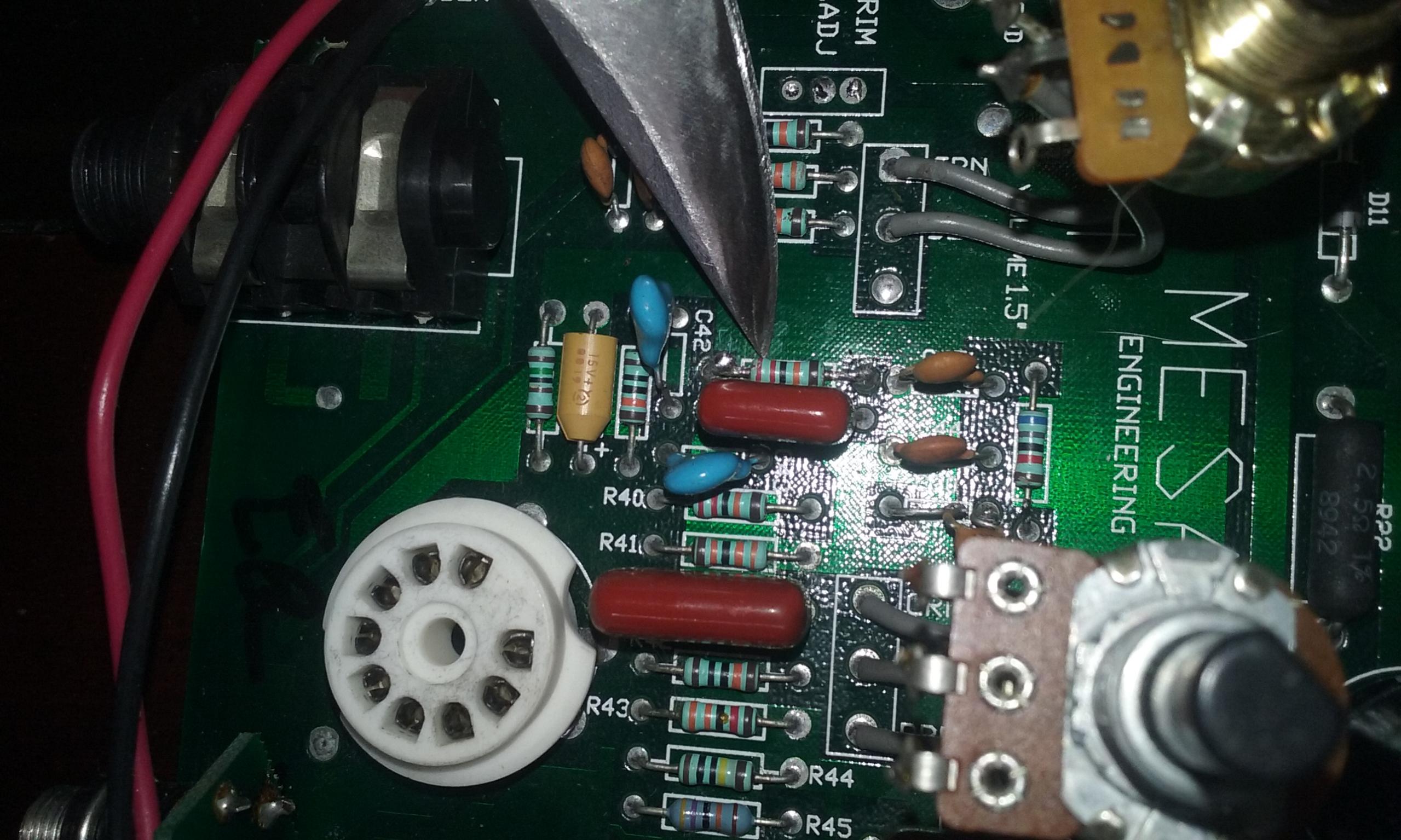

EDIT: i've found 2 220k resistors in kinda of a tricky spot, since the schematic says its NOT the one communicating with the pin2;
i've put the board against a light source to see better the signal path, yet no clear results.
with a multimeter set to beep shorted signals, i *Think* it's the red-red-black-orange-brown on the right side of a brown brick cap, pointed with a blade on the picture attached on this post.
as yall can see the pic, the 220k resistor that must be shorted is NOT the r40, is it accurate?
(the suspected resistor to be shorted isnt labeled such as r1, r2 etc)

Can't tell you much about the layout, just going by the schematic. I would think the input of the circuit is by the input jack side and the latter part of the circuit by the output jack. Otherwise you have the method used, see through the board and trace with a ohm meter. Might help out using the ohms function rather than the conductivity (beep) function because some resistance in series can still beep but 2k in the circuit will not read as 0 ohms while both will beep.
aw, thanks... i found it anyway, was that r21 non labeled as i suggested
well, i'm not sure, but it worked.
since that resistor was better than the 220k i had (mine was a brown one, striped red-red-yellow-gold)

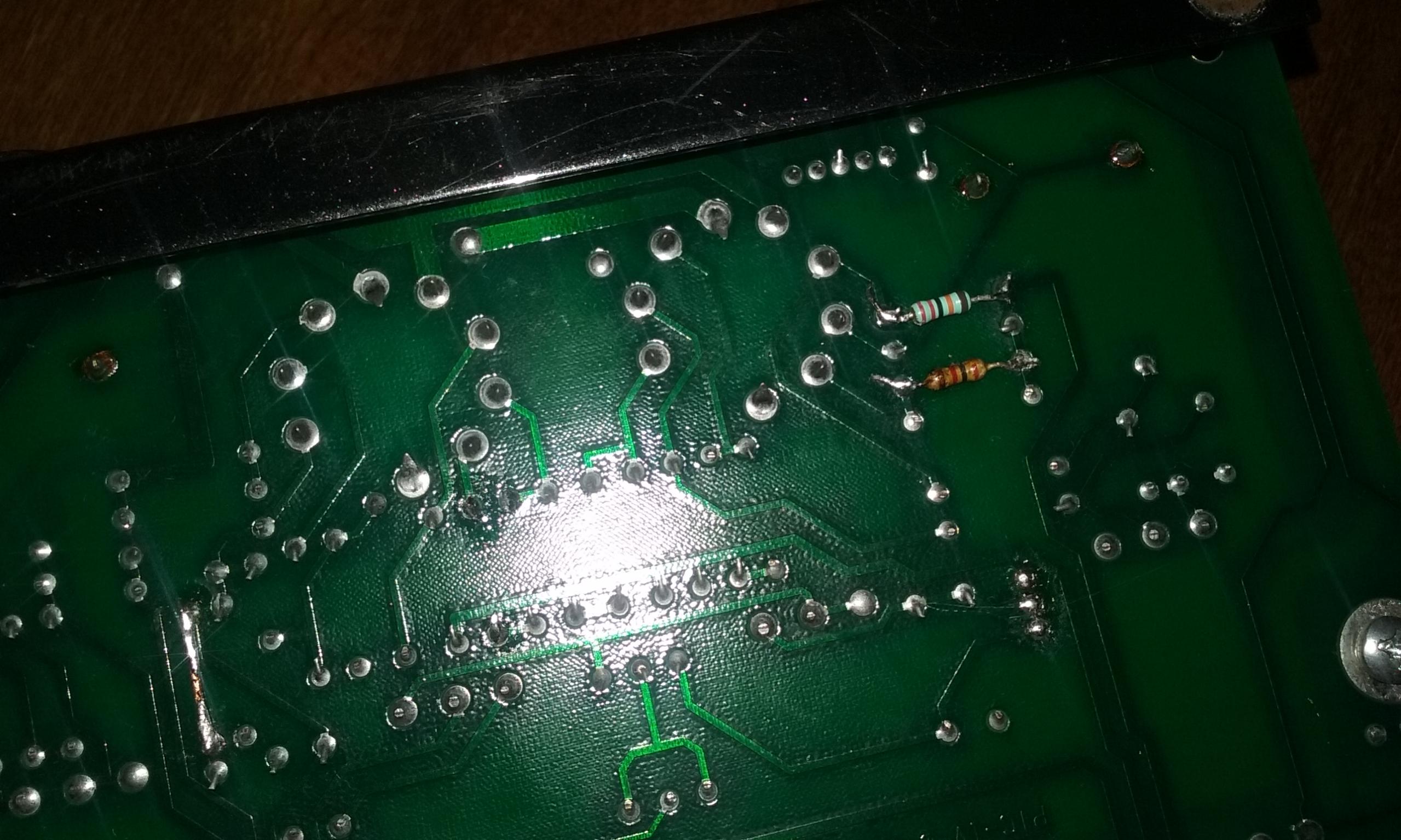

i decided to pull it to parallel with the stock 220k first plate resistor to drop it half, it worked very well (i piggybacked it for the ease of reversing the mod if i decide to sell the pedal someday)
i had no resource to drop the 2k2 cathode to 1k5, so i piggybacked a 2k resistor in parallel to it
now that i've tested this second mod (first was bypass the 220k sucka)

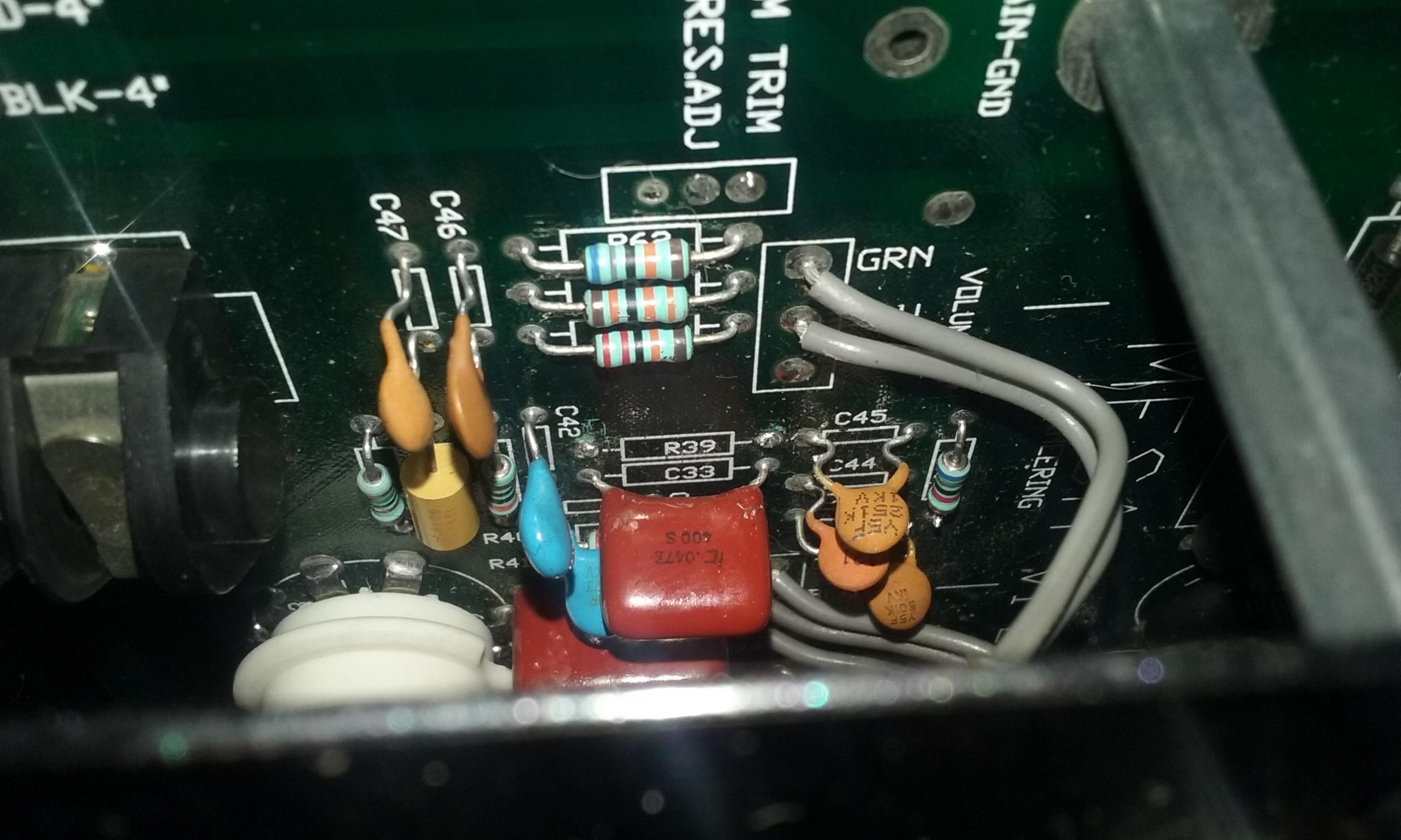

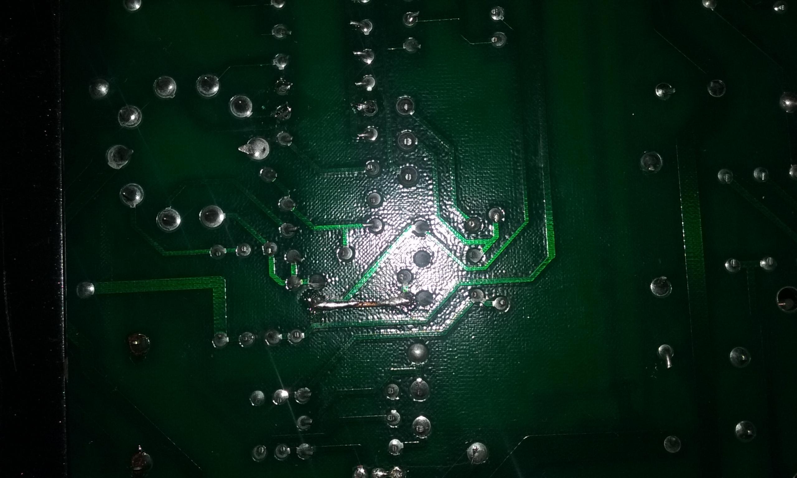

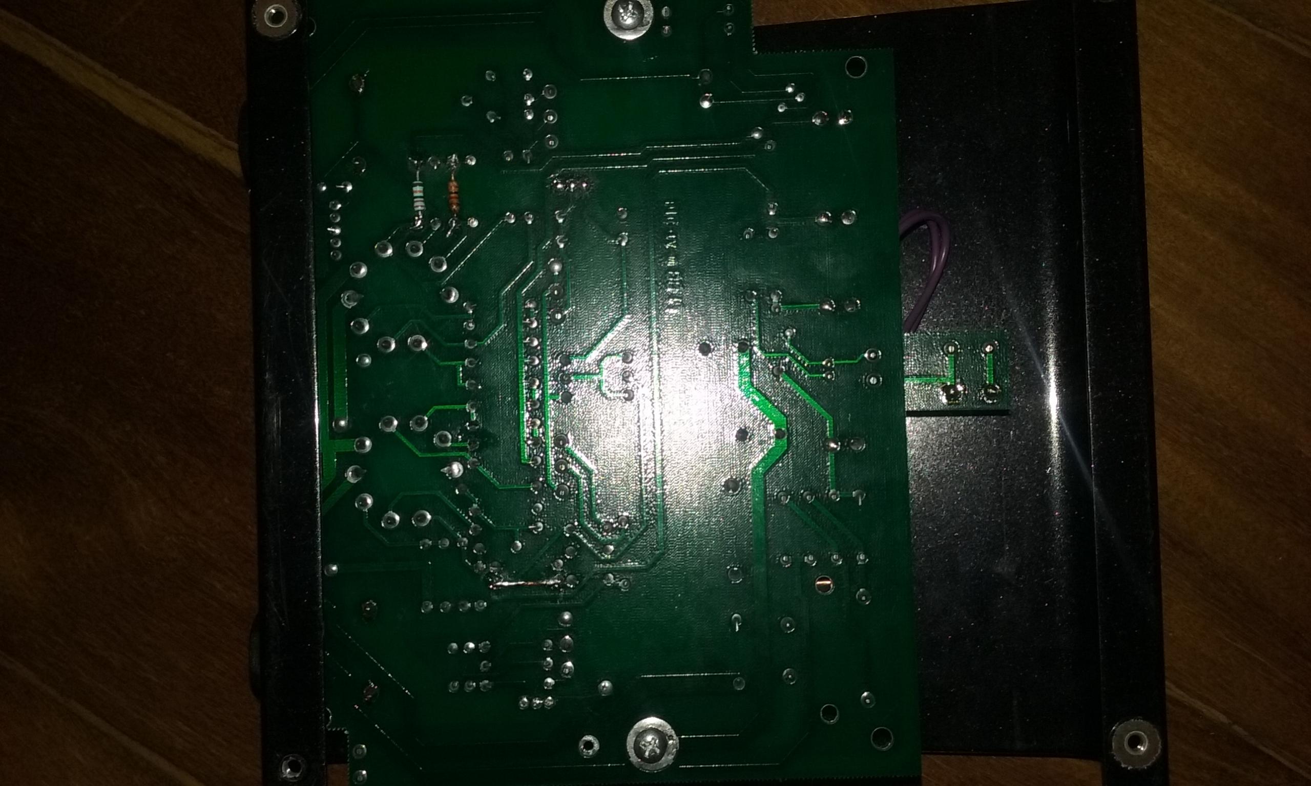

the pictures concerning the mods:
the blade pointing the r21 220k pre tone stack
the r21 removed and placed in parallel with the 220k first plate resistor
the 2k resistor piggybacked with the 2k2 cathode related to the first plate resistor
i forgot to photograph the v2b 33k piggyback (great mod to achieve fuzz tones)
the mid pot i just placed between ground and central slug slot a resistor of 37k i had lying around, dunno what happened 'cause its late to crank the amp, but i know it makes diff when i experimented 50k-250k-500k-1m pots.
its a great sounding pedal, thanks everyone
the other mods recommended i'll experiment monday and beyond, i'm looking forward to make it even more mid focused, but lets see what happen tomorrow at our gig... i'm not the guy who keeps pursuing an infinite goal of perfection, if it fits well... why bother some more?
