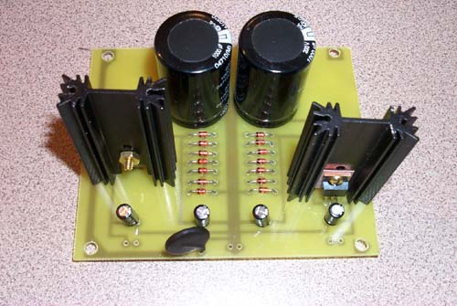

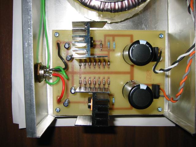

Another Power Supply for your Viewing
Moe29,
Just want to let you know that i've finished helping my friend build the power supply of this preamp.
I've built this power supply many times and will say this one is the best i've done so far. We used the same PCB design that I drew out on my computer and had a local shop make the boards for me. Design factors I considered was to allow the mosfets to be mounted vertically so you can accomodate larger size heatsinks. Also I tend to like smaller, compact layouts.
What really impressed me was the accuracy of voltage we got. After spending hours matching zener diodes and mosfets, I could not believe the output rail voltages were DEAD ON the same. Normally I would be at least a 1/2 volt out but this time it was like +57.4 & -57.4 VDC.
We used a single 300VA 50 + 50VAC toroidal transformer and ran each 2ndary to each bridge. For the caps we used 1200uF.
The regulation of the voltage is quite important. It would not matter if we used a 60 + 60 VAC transformer because the regulated output VDC would still be at 57.4V. The only drawback is more heat dissipation on the mosfets which is why the 50 + 50 donut had fit the job nicely (and the bill also). We confirmed this by use of my Varaic, as 57.4V would be reached at 200volts and as we increased the voltage to 240VAC, the voltage rail remained stable.
As for blowing up the diodes, I did NOT seem to have any problems powering up this board with no load on the output rails. Perhaps the abnormal super high voltages you measure were the cause of the zeners blowing up? I do know that the heatsinks do not heatup unless there's a load being drawn from the rails. So testing the board out on a bench with no load shouldn't present any problems. Triple check all connections - maybe you have the 2ndaries wired in series where the voltage will double up after rectification.

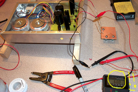

it works!!
just wanted to post and say that i finally got the power
supply working!
I'm a geek to be happy about a PSU working, but hey,
it's a start :)
thanks for everyone's help, just be ready when i ask more
stupid questions getting the main board working!
