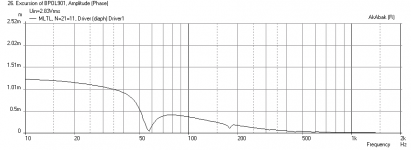

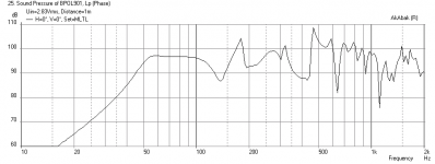

8-driver Bipole MLTL with Bose 901 drivers
It looks like the Dayton replacement Bose 901 drivers can be used to make a MLTL with pretty high speaker sensitivity. The bass doesn't go particularly deep but that is really limitation of the fact that it is a 4 in driver with a relatively low Qts. The speaker cone displacement is pretty low at 1 watt, and may run into issues if pushed hard - although it is pretty loud at 1 watt 1 meter (96 to 97 dB).
Design is 10 in wide baffle x 16.5 in deep x 45 in tall, drivers mounted at 13.8 in from top with as tight C-T-C spacing as possible and wired in series to achieve 8 ohm impedance. Vent is bottom firing with 70 square inch CSA x 4 in long, standing on 3.5 in tall legs for bass to escape the bottom.
