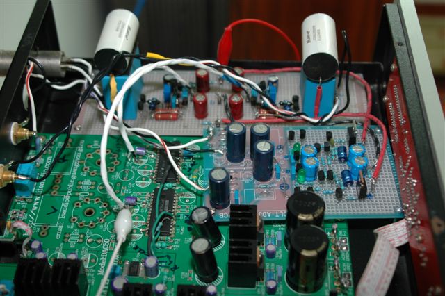

So far I tried DAC CS4398, PCM63, PCM64 (my old Denon player), TDA1541, TDA1543 etc.. but PCM63 and TDA1541 give the best result on sound quality. I guess AD1862/5, PCM1702 and PCM1704 should also give good sound. I am quite disappointed on CS4398 delta sigma DAC as the sound is too techno type.
I did not diy the digital part and I only modify the IV and buffer stage in DAC and the result is very good to me on PCM63 and TDA1541. I tried NP D1 IV before but the drive to pre-amp / power amp is lack of punch and sound too flat in my system.
Here is one photo how I put the Jfet IV and Borbeley low noise Jfet regulator in my DAC. I also added a Lundahl LL7902 audio transformer at the output to get Balance output to match my pre/power amps.
Spencer
Spencer
spencer said:So far I tried DAC CS4398, PCM63, PCM64 (my old Denon player), TDA1541, TDA1543 etc.. but PCM63 and TDA1541 give the best result on sound quality. I guess AD1862/5, PCM1702 and PCM1704 should also give good sound. I am quite disappointed on CS4398 delta sigma DAC as the sound is too techno type.
Thx for replying and for sharing the pix. The layout looks quite clean but I'll be sure to study them more thoroughly before attempting the project.
Earlier you noted "[t]his is a balance[d] version Jfet IV modified from NP D1". And above you note "I tried NP D1 IV before but the drive to pre-amp...".
This may sound like a dumb/novice question, but would you consider your JFET I/V a hybrid of sorts? That is, single-ended, like NP's (pre)amp designs, but with some of the virtures Borbely's JFET designs (minus the diff. stage) -- perhaps, a best-of-both-worlds approach?

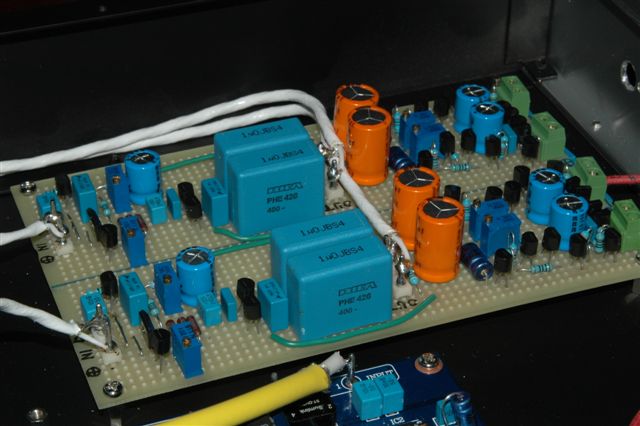

spencer said:This is a new version of Jfet IV with regulator in one single board in TDA1541 DAC
From the other photos you posted, I noticed you were modding, TTBOMK, a GR Research DAC-72.
I know GR also makes an 8-TDA1543s-in-parallel DAC called "DAC-AH" but I don't think they make one that uses TDA1541s. So, which DAC, if you're using a commercial one, will this new version of Jfet IV with regulator be used with?
