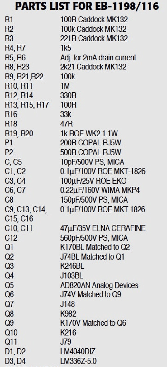

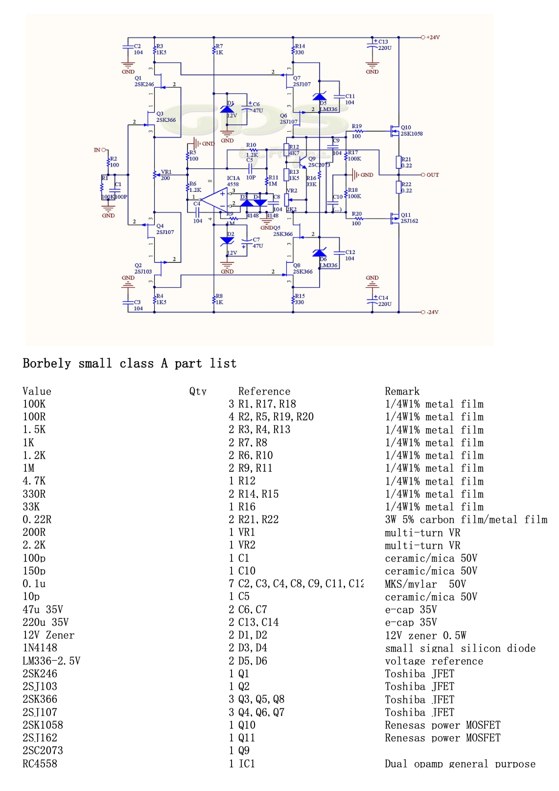

@nautibuoy - I already have those very PCB's BUT there is a problem in that the circuit these are based on is not identical to the original Borbely schematic, as I found out this afternoon.
I went out and sought the components from the original articles and, erroneously as it now transpires, that the PCs supplied by Stanton would be the same circuit - it isn't.
TBH I'm a little p****d off that Stanton doesn't make this very obvious.
The original parts list:-
Stanton's parts list:-
Regards

That's a shame Richard, I hadn't appreciated the variances.

I already have those very PCB's BUT there is a problem in that the circuit these are based on is not identical to the original Borbely schematic, as I found out.
This is what is in the description :
"The design is with reference to Boberly 2 stages cascode circuit EB1198/116 ....."
That sounds like "not identical" to me, to be fair.

Patrick,
I too can write carefully worded pieces of English which could be designed to obscure - there are 'significant' circuit and component changes.
Personally I'll take it as a 'learning experience' - needless to say I'll not be returning to this particular retailer.
In the meantime if anybody can direct me to a source for original pattern PCB's or an article detailing the PCB layout so I can draw up a replica in Eagle....

I've just tried Googling this hybrid design (the one with the single valve and can see that, again, such as the AudioExpress article refers to 'including several modifications' and the PCB bears the text 'Original circuit by Erno Boberly' both bits of information advising this is not the circuit as designed by Borbely himself.
Very frustrating if you want to build the original....
