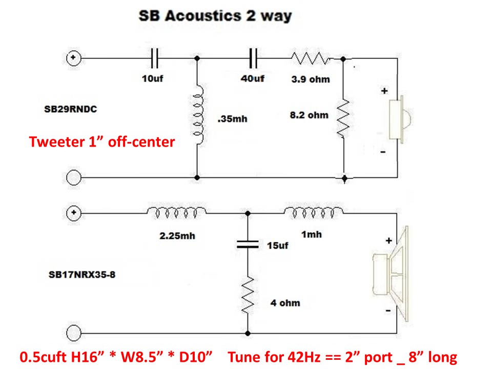

Hello there,
I'm having a few challenges reconciling my crossover design. I'm using Linesource's posts above to check my calcs.
The 3rd order Butterworth calculations I do using the cookbook formulas and online calculators result in series lower inductor values in the low pass than both the above designs.

Is baffle edge correction significantly increasing series inductor sizes in the two designs posted by Linesource above?
Also, I get different L-pad resistance results. I calculate similar parallel resistor values but lower series resistance values...
eg for 3dB attenuation of my 6 ohm tweeter I calculate 1.8 ohms series R, 14.5 ohms //R. What am I not taking into account?
Nominal Pete. 6ohm tweeter, 8ohm woofer. The online calculators give me the same results as the loudspeaker cookbook formulas. I wanted to understand Linesources design from post #11 better. Especially the L-pad and the baffle edge correction.

I haven't checked your specific case, but this should be because crossover calculators omit the baffle step effect. If you build a LP filter using simply a textbook crossover you'll end up with tiny bass, as this will be 6dB down from midrange/high. Baffle step correction is usually performed with "oversized" coils.
Again, this is a side effect of a baffle step compensation. You have to pad down the tweeter more than you expected, up to 6dB more.

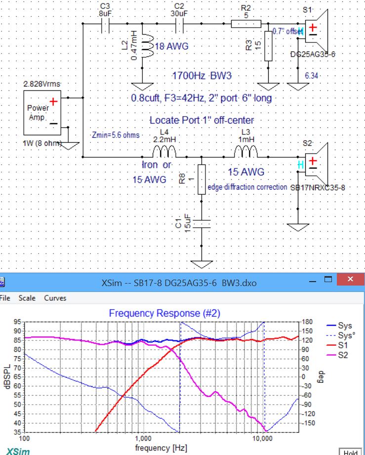

Hello again. I've looked into this some more and time is getting the better of me:) I need some help.
Could one of you fine people help me with the crossover design?
I will make this 18.5L, 38Hz slot ported enclosure:
SB 18 - April 2012 - Loudspeakermagazine 2012 | Loudspeakerbuilding
This crossover designed by Linesource looks excellent but I notice he's allowing for a slightly different enclosure (0.75cuft, 42Hz). Can I use this crossover design or does in need to be tweaked a bit for the 18.5L, 38Hz enclosure linked above?

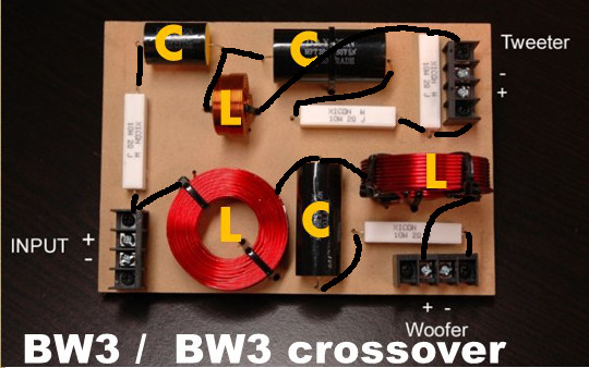

Here is my way. You also need to connect the - input with the - on the woofer and tweeter output. I had to make assumptions on all the resistors: one in front of the tweeter HP, two for a L-pad, and one in series with the cap in the woofer part.
Ralf

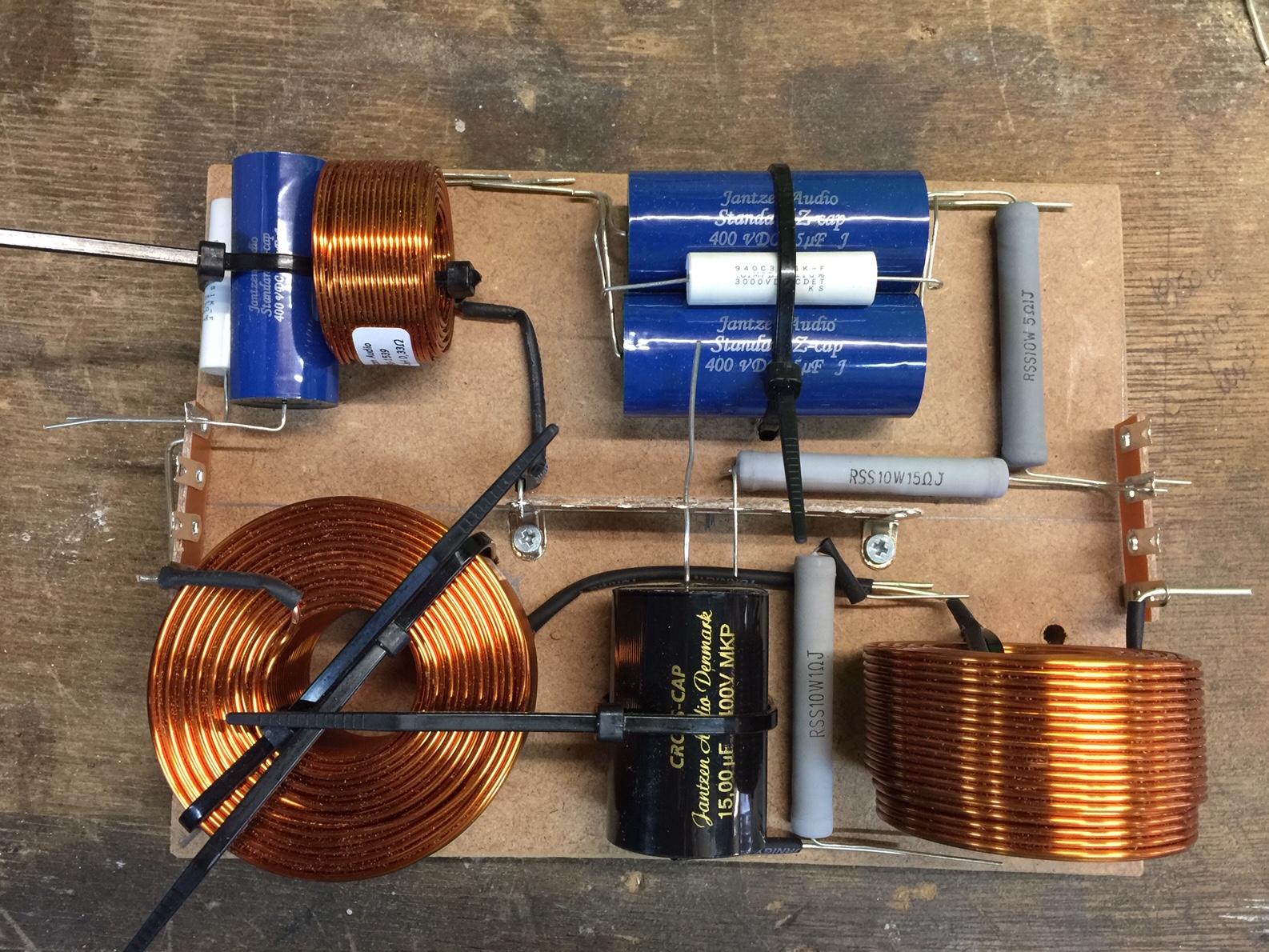

Hello again,
See photo attached. Seeking your feedback on the preliminary component placement for my BW3 crossover before I solder it together. Positive input on left. Both positive outputs on right. High pass across the top. Low pass across the bottom. A common negative ground rail for everything in the centre.
The main bit I'm not sure about is how close I have my first HP capacitor and inductor in the top left corner. I was thinking about moving them apart but that might compromise the position of the inductor wrt the first big inductor in the LP below. Maybe it doesn't matter? What do you think?
Anything else wrong that you see?
