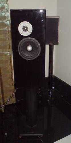

Once again, all the credit goes to Jay_WJ, with his continuous advice and support.
Below attached is my finished speaker without grill. at the back is spendor S3/5.
The volume for the cabinet where woofer installed is 19 liters but it works out fine. i added separate compartment to fit the crossover as my crossover is too big to fit into the initial woofer compartment. which work out very nice for the stand that i have the tweeter is around 1 inch higher than my ear on listening position.
The cabinet is painted with piano black color and made of 3/4" MDF with double front baffle, top and bottom.
sound impression is SUPERB. one word to best describe the performance. Attack, dynamic, soundstage is unbelievable. My spendor is way behind. totally different league.
noise floor is so much lower than the spendor. very quiet and low distortion. bass is excellent, especially driven by high power mosfet amp of 150w. even can shake the ceiling and windows.
it play much louder than my small spender though the rated sensitivity is lower than spendor. guess its system synergy between the amp and speaker.
