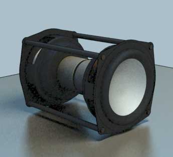

MisterTwister said:with such limited space I would get another pair of woofers and attach them back to back with existing ones and get rid of baffle completely.
You mean using boxed setup? I don't think so

Is there an alternative to the standard two-way bass reflex speakers? I need a pair for my new workplace, they will be placed on a shelf on the wall across the table, cca 80 cm from listening position and ca 60 cm apart, tweeter/fullranger at ear height. I would like to try any of the other configurations except from bass-reflex (dipole, horn?). As an alternative, I can use the whole shelf for a speaker in a size of an ordinary floorstander, it would have to contain both enclosures at once - then it could be placed on the bookshelf holders without the shelf. As an amp, I have an almost vintage 2x20 W Sansui integrated amp (4 ohms capable).

CLS said:And, are there any program which can simulate that back to back baffleless dipole?
The distance D between two drivers (point sources) can be sufficiently simulated by a circular baffle with the radius D.
Thanks for the hint
If so, that would be pretty close to a fit/small U-frame with a depth of "D". So, in the back to back arrangement, the D should be large to justify the additional driver.
Then I guess if the distance of the 2 drivers is larger than a certain point, the relevance with "virtual circular baffle" should be diluted, no?
And, the accoutic center of this assembly should be at the middle point between the 2 drivers. That'll be both insteresting and odd.
I'm thinking of messing with 2 x 18inchers by this arrangement, using mininal baffles for each and keeping them 2~3ft apart.....
You might read Linkwitz´ explanation of such a "Compound dipole" woofer first.
