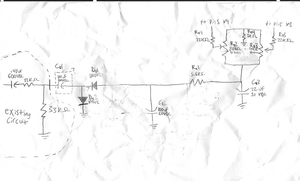

Okay, I was looking at some other circuits and got to thinking, why can't I just change the cap and resistor values to change the voltage? This is what's reccomended on the Triode Electronics site for the Quiksilver 8417 amps, why not the Bogens? I think it would be much easier then cramming in more stuff.

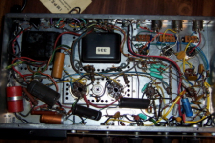

Although I'm not getting much input here anymore, I'll at least say that I got the tubes tested. The 8417s check out good with similar results. The 7247 is in incredible shape, from how it looked on the tester I think it will outlive me.
Strangely, the 6EU7s tested completely dead, but this can't be the case because they light up and I was getting sound so they obviously can't be dead.

I agree. If the filament lights you will get some kind of reading on at least one tube. Test them in circuit by measuring the plate voltage and also the DC voltage across the cathode resistor (to figure out the current draw).
I really wouldn't worry about it unless you have changed the coupling caps and have no/low signal.

The 6eu7's of the m60a amp I just sold had a bad set of 6eu7's that I replaced. A bad tube may still light up. The cause of a bad tube may be the result of leakage. That is why one of my tubes was dead. That may also be the cause of why you had that loud noise when using the amp. On another amp I had the 7247 had leakage and it caused a lot of noise and half the tube was dead and the tube filament was working just fine. I also have some 8417's that were used alot and are almost dead and still fire up. Also did you make sure to test both plates of the tube?
True, but the tube tester would still read something.A bad tube may still light up. The cause of a bad tube may be the result of leakage.
That's why sometimes it's best to troubleshoot the tube in a known good circuit.

The needle was as far the the left (bad) side as it could go for both tubes, due to the strange pinout of the 6EU7 it could have just been a matter of his tester not being set up for them. The "loud noise" I heard sounded awfully like an explosion of some sort, could that be a result of leakage?
On another note, I got adventurous (or stupid, take your pick ) and fired up the amp without tubes. No hum, and and all the voltages were normal. Then I put the tubes back in (stupid, I know) and fired it up again. It's acting exactly like it did before, barely audible hum but low volume. I didn't keep it on long and I don't intend to fire it up again without new caps, but it seems to be alright.
What puzzles me is that if there's no hum, and all the voltages are fine, what could have exploded?

I'd rewire the socket for a 12ax7 and use one of your 12ax7 spares.
I've had tubes that light up but are dead. Or at least one triode section. Since you know it is dead, don't use it.
I haven't looked at your schematic but when I was debugging my HK PA amp (with help from this forum) I was able to bypass the tone stack for initial testing.
Once you get your new parts installed, hookup a load (old speaker), short the inputs and measure every pin on every tube.
Post voltages. I like Va for plate voltages, Vk for cathode voltages, Vg1, Vg2, ... for grids. Don't forget to check heater voltages. My HK used the heaters for the driver tubes to bias the output tubes. I pulled the mic driver tubes so the output tubes were not getting biased. This threw me off until more wiser members straightened me out.
We can start looking at suspect voltages (input grids should be zero or less), cathode biased sections should fall within spec, ...

I'm holding off on ordering parts until I get this stuff figured out. I like to have things planned out before I start. I'm on the verge of getting the bias supply design right, and once I get that finished it's time to order the parts (finally).

There is a very easy way to test if the 6EU7 (excellent tube BTW) is working. Plug them in and see if they are drawing current. If the current is in the normal range, chances are the tubes are good. Might be noisy but they will pass signal.
The "normal range" requires a schematic. I would just compare to the drops a 12AX7 gives in a similar circuit.

I've been prodding around testing voltages most of the day and just for the heck of it I fired it up and ran some music through it. I don't know what happened but it was loud when I turned it up. Of course I had to see what it would do with a guitar input . I plugged it in and immediately notice two things: First, it shook the walls with the input and master volumes turned to "5". Second, it sounded awful - no high frequency sound at all. Then I remembered that, being a PA amp, it had a treble cut circuit on the RCA jack inputs. I plugged it into the "aux" input to bypass the first gain stage. It sounded great, and even though it only went through one preamp stage it was still pretty loud. I didn't turn it up enough to get distortion, I can't wait to get my new caps and the stuff for the bias supply mods so I can start turning it into a real guitar amp.
It's amazing how often things work out like that - all you have to do is take it apart without changing anything and it ends up working .
