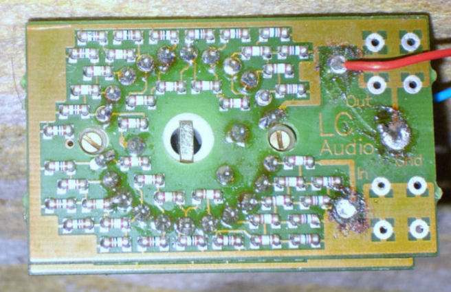

I made a simple to the book line amp of 4562.It sounds very good, from bottom to top
but it can't be used with an attenuator.There is a cracking for every snap and my power amp shuts down.IOt works ok with a pot though. Offset it .3 mv on one channel and 3 mv on the other.
I think there's bipolar transistors as input as fets would give no offset.Thats also why the attenuator makes noice although it's a make befor break
It sounds like your attenuator has a break-before-make switch. No opamp really likes to run with input(s) open, even the JFET and MOSFET input types need some sort of impedance to common. The 4562 is a bipolar input amp, and would like to have a dedicated resistor to ground on the input where the attenuator is connected. This is just a guess at this point, but 100k or so to ground would probably keep the opamp from going totally berserk when the attenuator switches. What you need to do at this point is to calculate the voltage step that occurs when the attenuator wiper is between contacts and the only path to ground is the fixed resistor. Use the bias current specs for the opamp to calculate the voltage step and choose a resistor value accordingly.

I agree with Andrew T - a series resistor will not work. I suggested a shunt resisistor to ground, so that there is always a path for bias current. Given the things that can happen (as evidenced by this event), a shunt resistor to ground sounds like a good safety measure whether you're using a switched attenuator or a pot (wipers can lift, too). The 4562 has much lower bias current than earlier comparable opamps, but it's stiil very much there and needs a path to return for the opamp to function properly. I'm using a law-faked pot for volume control, so the safety resistor is already in place.
