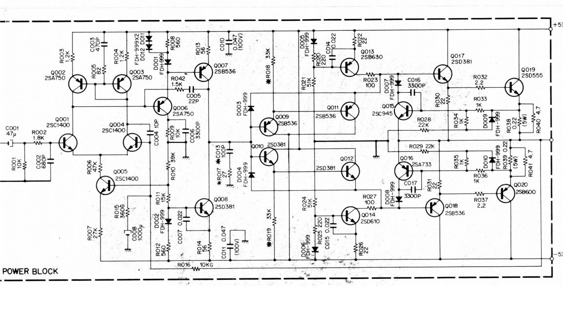

DBT amps...
The nakamitchi 620 is close (below 1). I simulated , but did not build it. It was not as strait forward in it's T- comp (D 003/004 and Q 009/010 are coupled to the main HS). It also is a voltage follower style current amp (buffer), but still a triple... with 100K+ hfe. As I was not yet skilled enough 2 years ago , I passed on it and did an easy EF2. :eek:
Bryston also has a similar idea , I found a thread on it here .. Discrete Buffer Design
Some sort of crazy CFP - diamond hybrid
Neither is as "slick" as the "DBT" :D
It is not a great technical leap to put a diamond buffer in front of a pair of output transistors and arrive at a nice Triple.
No , it isn't ... but to "popularize it" and create a stable , durable alternative to CFP's and EF2's for driving demanding loads is very much needed here at DIYA. I hate to see some paralleling 6 or more pairs of devices with an emitter follower (ef2) and calling it a high current , high power amp .
OS

It is not a great technical leap to put a diamond buffer in front of a pair of output transistors and arrive at a nice Triple. I am, however, unaware of specific commercial power amplifiers that use this circuit. I'd like to reference these in the next edition of my book. Can you provide me those examples?
Thanks!
Bob
Bob I think you are only going to find 2, maybe 3 and all by the same manufacturer, namely Pioneer. The circuit was used by them in around 1983-1988 in their exclusive series of amps. One of the models is the M6.
