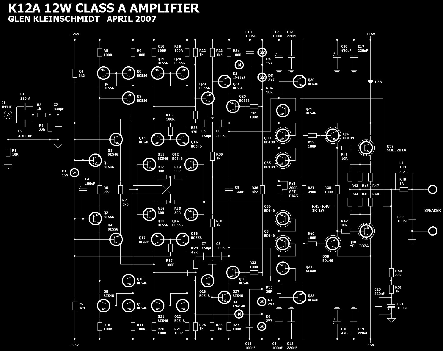

The discussion on VAS clamp diodes reminded me of Glen's K12A design. Glen combined the diode clamp with his solution for setting a fixed current on complementary differential LTPs with both cascode and current mirrors.
Has anyone built Glen's K12A who can comment on sound quality, and how well his VAS clamp+current_bias solution works?
Hi Linesource,
One of the most complex 12W amplifiers I have erver seen .
Anyway, I took a quick look at it and I couldn't find the clamp diodes, but it is early in the morning.
Bob
