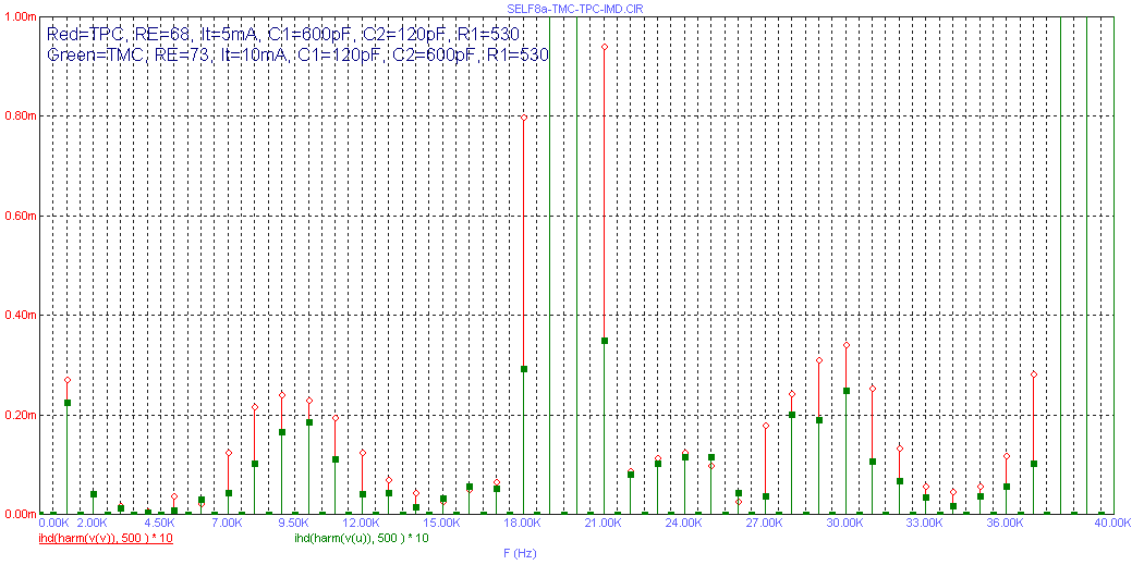

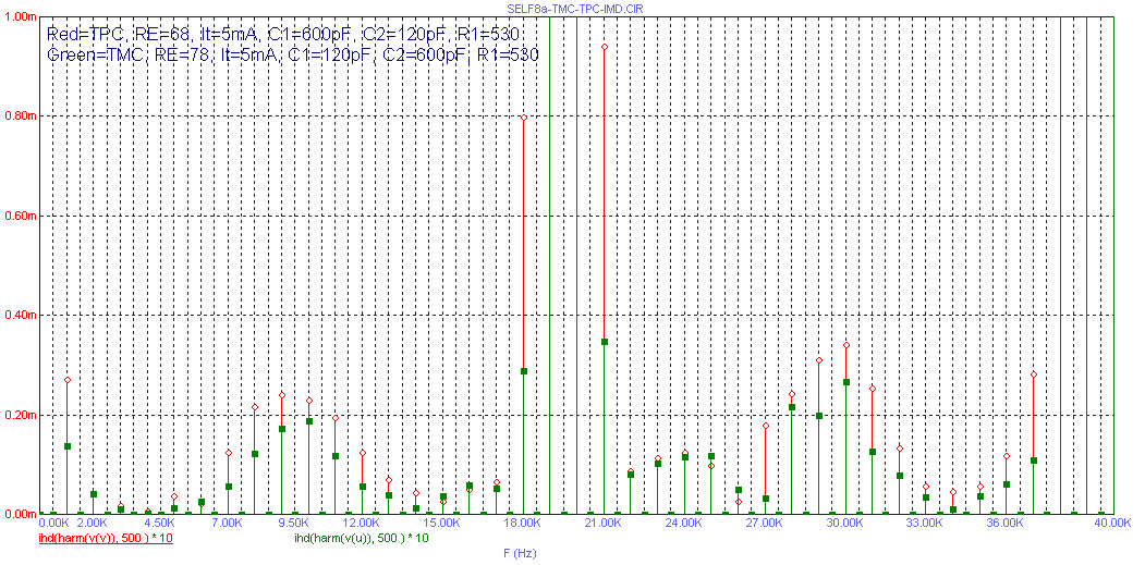

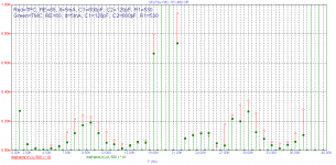

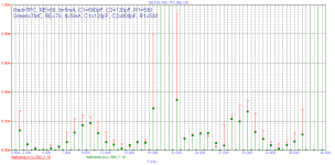

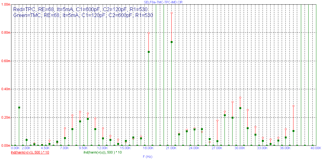

Some sims i posted by there clearly show that TMC has higher
undesirable frequency products in 19+20khz IMD for the 1KHZ
product and subsequents 18 and 21khz products.
Edmond suggested the IPS non linearity due to increased output
current from this latter in case of TMC higher IPS loading.
I still do not agree with this explanation, as i provided a sim
that show that reducing the IPS degeneration yield a reduction
of all IMD products safe the one mentionned, meaning that the
increased available NFB indeed act on part of the signal while
being totaly inneffective for the 1KHZ, 18 and 21khz products.
Increasing the VAS gain AND slew rate by reducing the cap that
goes to its input effectively reduce those reluctants products,
meaning that VAS+OPS slew rate is the cause of this distorsion.
Indeed, IMD appear when a fast system drive a slower one.
As a cure, one has to increase the slew rate and subsequently
the VAS gain at about 20khz, and in this respect, the best is to use
a mix of TMC and TPC, that is connecting the TPC and TMC resistors
to ac ground and output respectively, as usual.
Adjusting the ratio of the two resistors will allow to transit from
pure TPC compensation to pure TMC one.
We can then choose an equilibrium that yield limited overshoot
while retaining the TMC better usage of local NFB (better thd reduction)
for the inevitably gain dumping VAS compensation.
Moreover, this allow to use a very light phase lead compensation
to completely suppress the TPC influence induced overshoot, rather than
an oversized one in case of TPC alone.

Some sims i posted by there clearly show that TMC has higher undesirable frequency products in 19+20khz IMD for the 1KHZ
Edmond suggested the IPS non linearity due to increased output current from this latter in case of TMC higher IPS loading.
I still do not agree with this explanation, as i provided a sim that show that reducing the IPS degeneration yield a reduction of all IMD products safe the one mentioned, meaning that the increased available NFB indeed act on part of the signal while being totally ineffective for the 1KHZ, 18 and 21khz products.
Increasing the VAS gain AND slew rate by reducing the cap that goes to its input effectively reduce those reluctant products, meaning that VAS+OPS slew rate is the cause of this distortion. Indeed, IMD appear when a fast system drive a slower one.

Hi Wahab,
Firts, my apologies for not responding to your previous post. For some reason I missed it.
What do you mean by "safe the one mentioned" ? Probably "except the one mentioned" (i.e. 1, 18, 21kHz), right?
Anyhow, I got different results from slightly different circuits. The compensation components are as follows:
TMC: C1=120pF, C2=600pF, R1 = 530R
TPC: C1=600pF, C2=120pF, R1 = 530R (Harry's style)
Opposed to previous sims, with these arrangements the IMD products of TMC are equal or lower compared to TPC (1st pic). But in other cases they could be higher due to a higher load of the IPS (the devil is in the detail). This can be remedied by increasing the tail current, which makes the IPS more linear, see 2nd pic. Indeed, the IMD is lower now.
However, due to a higher tail current, one might argue that the higher slew rate attributed to better IMD figures. So I lowered the tail current to its original value and linearized the IPS in another way: by means of Sziklai pairs. Also in this case, IMD figures are better (3rd pic). Therefore, I still believe that the IPS caused more IMD as shown in previous sims. BTW, also notice that the 'reluctant' components are reduced as well.
