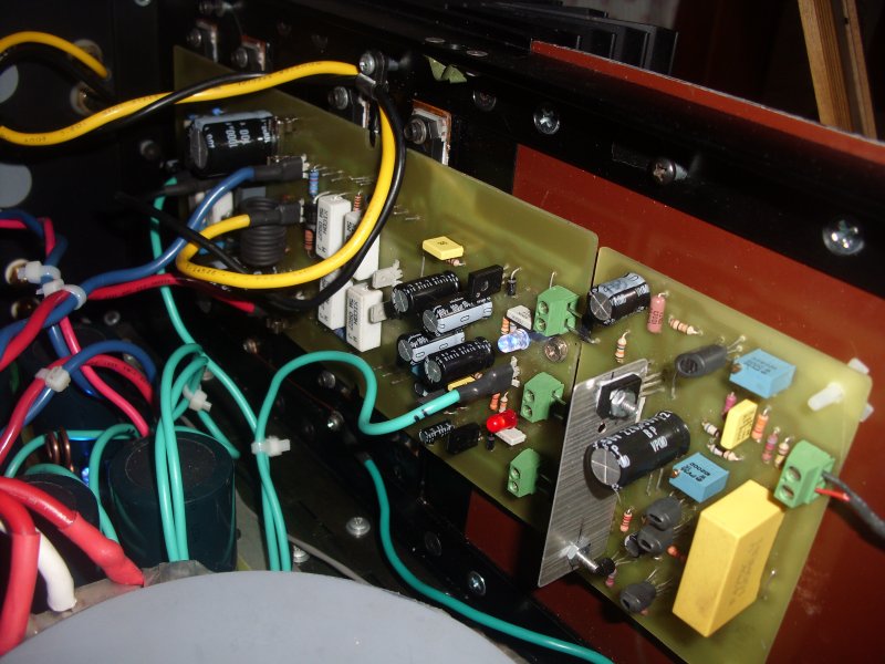

Just a few questions ,Bob . Your example amp in chapter 3.8 /figure 3.14 looks EXACTLY like my AX/PB250 but with a triple. You also say it can produce 580W/2R .
That seems to be on the "hairy edge" for both the MJE15032/33's and the 4 pair MJL21193/4 OP's with SOA considerations. At best that would be 1 second on the MJL's SOA at 65-70V rails. I actually am going to build this example as a triple with OPS= 2sa1381/c3503 (pre) - njw0281/0302 (To-3p driver) - 6 PAIR NJW21193/4 (to-3p OP's) for my subwoofer amp project. Am I just going overboard , or is the example just a tad over-rated ?
PS. I am not "picking" , but I really have this amp (below - 4X njw21193/4) , and would not run it at 580w !! A very worthwhile design that runs flawlessly ... but not at 580w !
BTW , simulated THD20 this amp does .008% at 580W w/TMC .

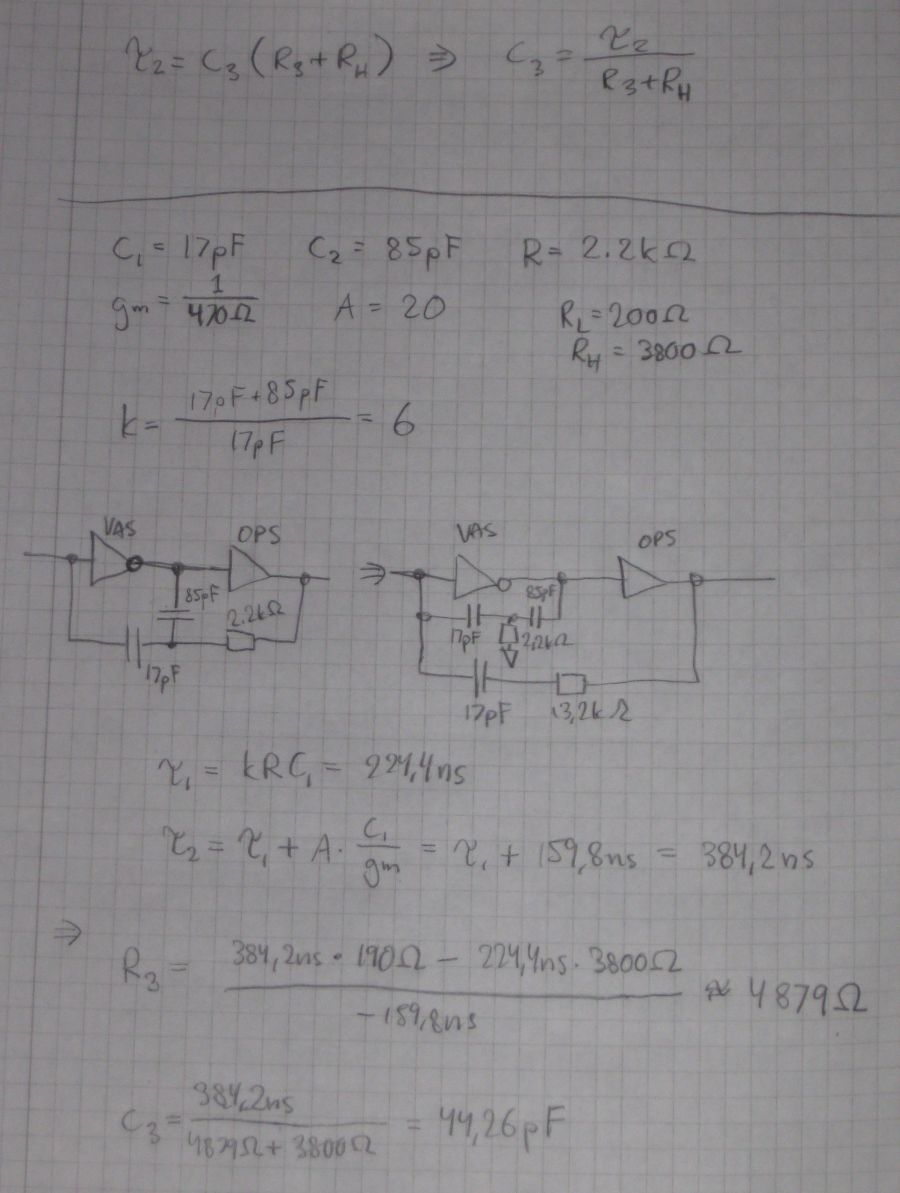

Hi Joakim,
Thx for the derivations. The transformation is correct, except for thing: the loading on the VAS output. Between 10 and 100kHz it is ~10dB higher. As a result, somewhat higher THD20.
E.
Yes, the loading on the VAS and its local feedback is different. I was only looking for a network with the same input-to-output and feedback-to-output transfer functions.
However, it is possible to replace the TPC network afterwards with another one giving the same VAS transimpedance. Use for example the values 2 x 28 pF and 4 kohms that was used in Bob's TPC simulation which loads the VAS less but gives the same transimpedance.
With these values I got distortion a tad lower for TPC+lead than TMC in the simulation. Perhaps it's the decreased signal level at the LTP that makes up for the increased loading of the VAS. Especially as the loop gain around the LTP is lower for the TMC version.

That thing is just the intermediate step that is used to calculate what current is needed out of the LTP to make the TPC+lead and TMC transfer functions equal. That lead network is then removed and the series combination of R3 and C3 is connected across the feedback resistor which gives the same effect.
The intermediate step connection by itself doesn't have any advantages compared to TMC what I can see. The component count is higher, the VAS loading is higher, the LTP loading is still high and the loop gain around the LTP is also low at audio frequencies like TMC.
However, when the lead network is transformed to the input side of the LTP the signal level handled by it is decreased at audio frequencies and the loop gain around it is increased.
Hi ostripper,
Very good points. First of all, the amplifier evolution examples in Chapter 3 were not really designed with a great deal of consideration for real-world SOA, especially driving 2 ohms. They were designed more for showing examples of the design evolution than for real-world use, so some of the output stage sizing was just swagged. If I wanted to wiggle out of it I could say that the amplifiers were not designed to drive 2 ohm loads continuously, but that it was desired to show distortion performance into such a load .
Your choices for building a real-world design for a subwoofer I think are quite good.
Bob

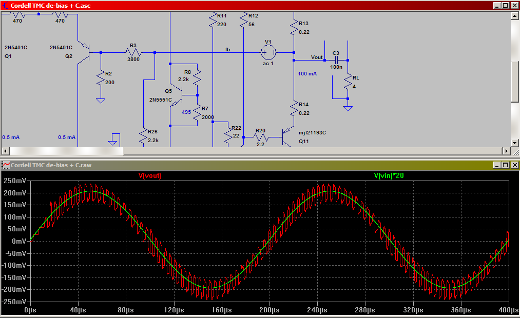

But the TMC network is a feedback path, just that it bypasses the LTP.
Why this worry about increasing the gain crossover frequency from 1 MHz to 1.7 MHz in the loop around the input stage when you had it up much higher (wasn't it tens of MHz?) in the "input inclusive compensation" scheme? At the same time why are there no worries about the increase of gain crossover frequency of the loop around the output stage from 1 MHz in the original single pole compensated amplifier to 1.7 MHz in the TMC version?
Isn't it the output stage with its load that has the big unknowns in its transfer function at single MHz frequencies and needs the phase margin and is the reason we need to be careful with our crossover frequency?
Both the TMC and TPC+lead versions have the phase dip at ~20 kHz in the loop around the output stage. Why is this okay while the LTP must not see the same phase dip? The output stage loop crossover frequency will be in that range when the stage is starting up, when bias and thus transconductance is low. If the output impedance of the output stage is high due to low bias and the load is significantly capacitive at this frequency there may be trouble both for the TPC and TMC versions.
Wouldn't a "fair" comparison be one where the forward gain and feedback gain of the front end (including LTP, VAS and compensation network) are the same, giving the same loop gain and crossover frequency around the output stage? This stage is the one that is slow, has high distortion, large parasitics and moreover large unknowns in initial parameters, significant output current depedency and load dependency in its transfer function.
Here's for example what happens with the earlier posted TMC sim if the load is changed to 100nF in series with 4 ohms (looks like a typical Zobel network!) and the bias of the output stage reduced by changing the 495 ohm resistor to 2000 ohms. The input signal is 5 kHz 10 mV pk sinewave and the amplifier oscillates at about 200 kHz.
It doesn't look dangerous neither for the amplifier nor the speaker though with such a low amplitude.
