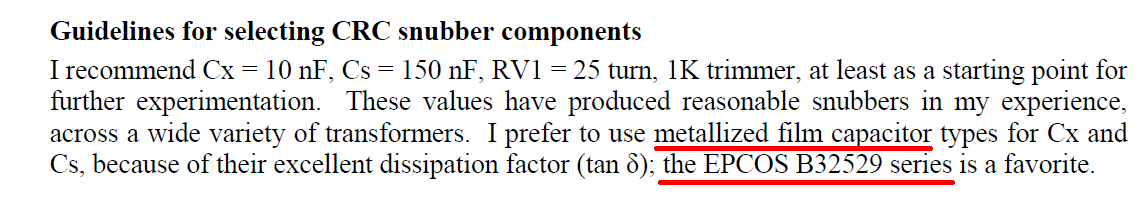

Hi all. On page 383 of Bob's book he talks about film type snubber capacitors. I was just wondering are tantalum capacitor ok to use or are film type capacitors better. If so please provide a explanation and details so I can understand.

Hey Stu, snubber caps are best metalised film or film foil with low resistive losses. At the mains frequency the relatively high Xc protects the snubber resistor from too much continuous current and at the much higher secondary resonance frequencies the much lower impedance allows the resistor to dissipate all the ringing energy. For a short time the resonant current could be quite high so the cap needs to have a reasonable pulse current rating.
Capacitors with an X or Y rating for direct connection to mains are very reliable for connection across transformer secondary, are readily available and fairly low cost although they are fairly large.
See RS Stock No. 869-7469
This is 250Vac, 100n X2 with pitch of 15mm

I read a bit of that thread awhile ago I will re vist it and look into this further. However I fine it very puzzling that nobody can offer a single part number of a snubber capacitor that they have actual used in an actual amplifier build....

I used this exact capacitor in a CRC snubber connected across the transformer secondary, of an actual amplifier build. Carefully note: the capacitor was NOT connected in parallel with a diode; it was connected in parallel with the transformer secondary. This particular capacitor was mentioned by name in the Quasimodo design note, shown below.
