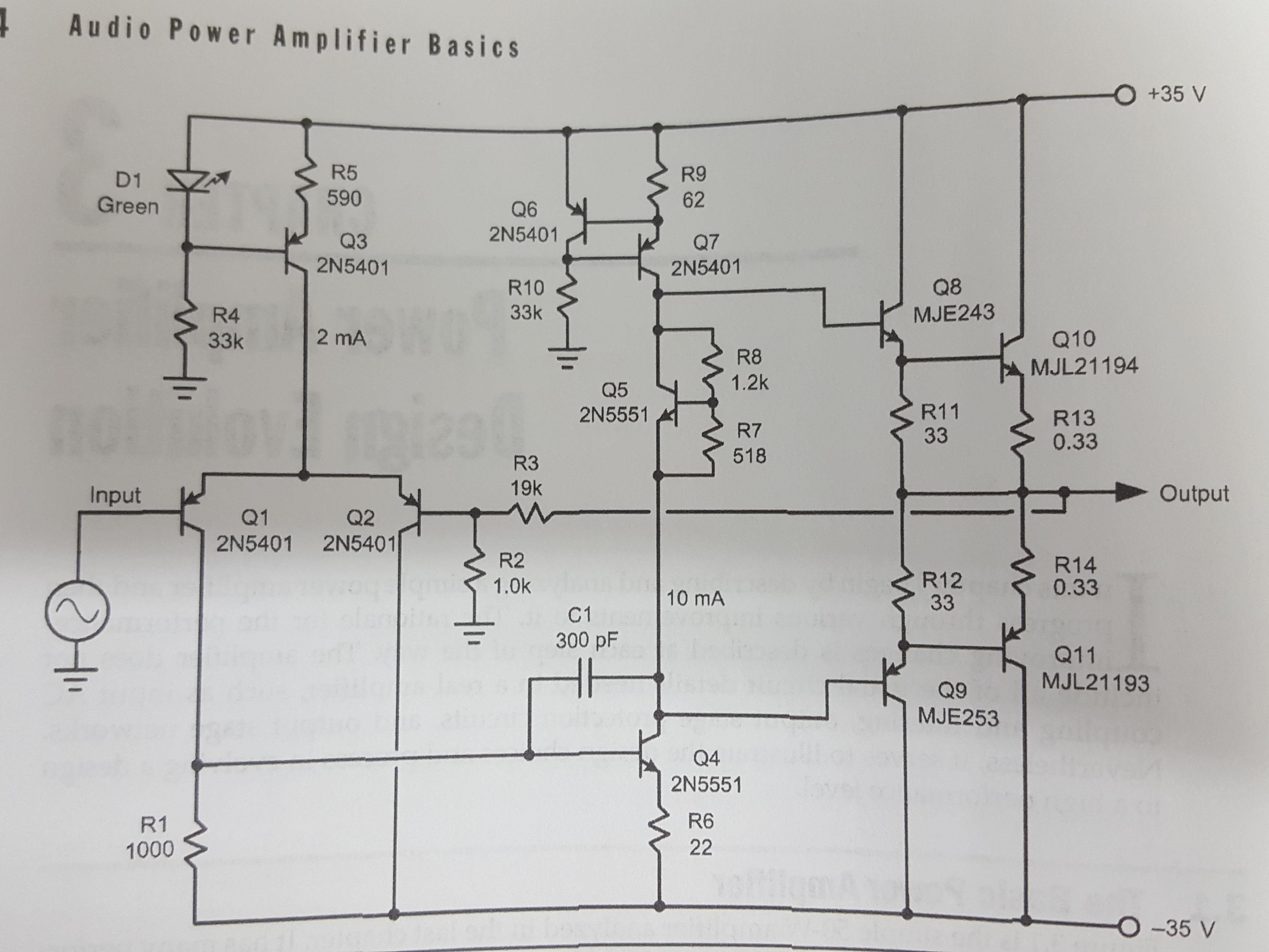

Help on Open Loop Bandwidth - Cordell example
Hi
I am studying Cordell's book Audio Power Amplifiers and I have a question on Open Loop Bandwidth.
If you refer to the example amplifier in Figure 2.12 I can't get how the Open-loop bandwith is 613Hz as illustrated in Figure 2.15.
That value should be when the Miller capacitor steps up instead of the input stage load resistance, and I am maybe caught in a Friday evening mind obfuscation, still I can't figure out the math?
Naturally, all the other discussions about open loop bandwidth in the examples that follow this one (so adding current mirror to the LTP etc) are not clear to me either.
the DC gain is determined by a number of poorly controlled and significantly varying with bias condition, operating point, loaded transistor parameters
fortunately the DC gain and its intercept with the dominant pole, "the open loop bandwidth" is relatively unimportant to audio amplifier performance and stability analysis
so you could prioritize mental effort and accept that there will be some uncertain by order of magnitude DC gain intercept/ "open loop gain corner" and leave it for later (or never)
other circuit optimizations may push up the DC open loop gain but are usually pursued for their linearizing effect on open loop gain without ever setting a DC gain/open loop corner frequency goal or calculating their DC gain effect

Yeah I eventually went on and left the verification for when I'll have time to work on qucs and a proper simulation. I am fine now with the understanding how the Miller compensation works, poles zeros and all that.

This is exactly right. Sorry for the confusion; this aspect of my discussion of open loop gain can probably be better explained and emphasized in my upcoming second edition, maybe even in more than one place in the book to drive the point home. DC open loop gain can actually get crazy high in some of these designs, especially in simulation.
What really counts is the open loop gain at frequencies above the intercept with the DC open-loop gain; like usually 1kHz and above. In other words, the open loop gain that matters is when it is being controlled by the compensation, such as the Miller capacitor, and is falling with frequency.
For all of the same reasons, open-loop bandwidth in these sorts of designs does not matter.
