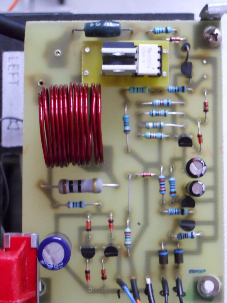

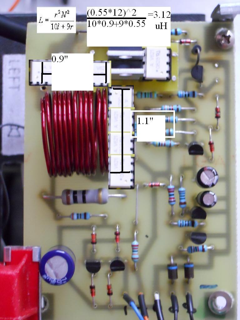

Interesting discussion. Coil design and theory is something I've never really studied in depth and so I would be interested to know a 'guestimate' of the value of these.
What is the diameter, length, number of turns and AWG?
Bob

For the one, about 3.12 uH (making some geometry assumptions).

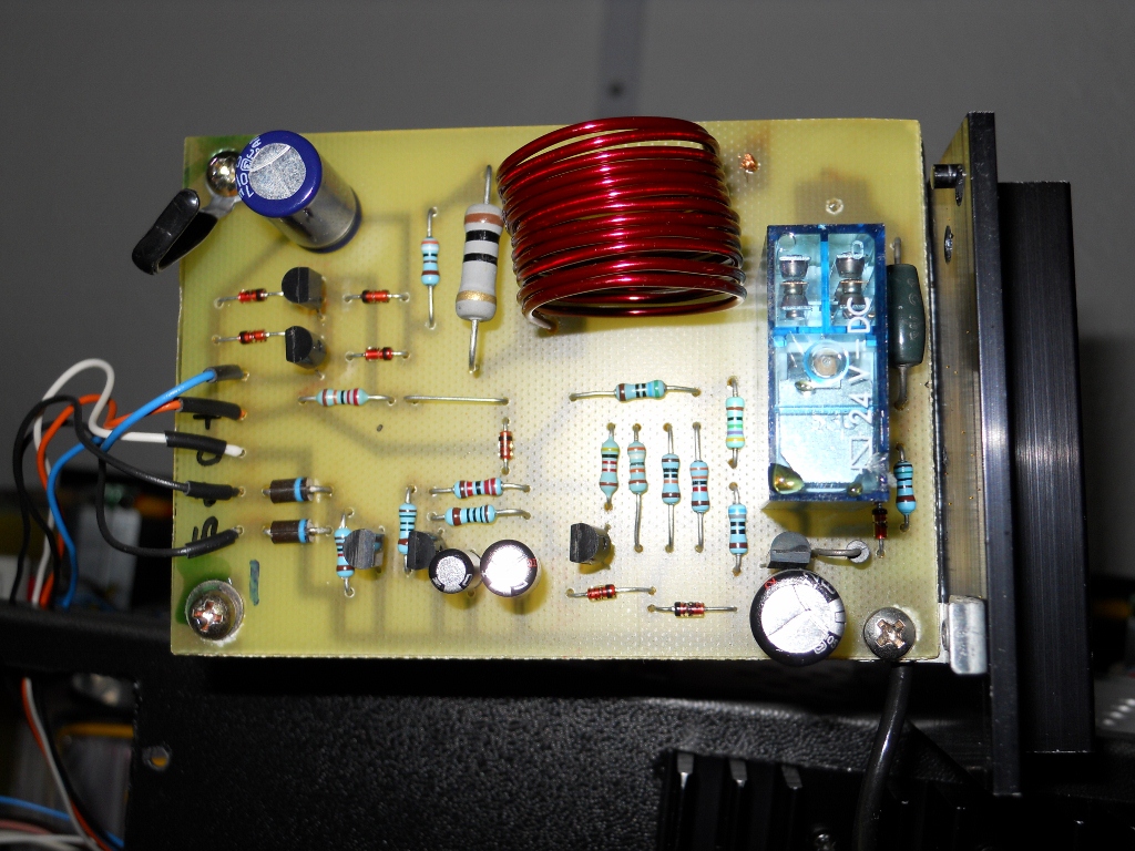

Many thanks for that I'd say your estimations of size are definitely in the right ballpark... in fact I have the relays in front of me right now as a scale check. Brilliant, ta very much
Mechanical relay in one image, solid state in the other because the pics were from 4yrs ago when I did the swap.
Up until very recently I'd always considered the output inductor as a very non critical part in the scheme of things. Perhaps these are a little on the large size value wise, based on current opinion. In fact I suspect for 99.9% of situations that the amp doesn't technically need them as it has a deliberately included 0.22 series output resistance. They were included for completeness as much as anything.
Bob
Well its all neatly plumbed into its rack... so getting all that info would have been a major dismantling exercise, hence the guestimate bit I don't even know the exact wire gauge tbh, just that it was fairly 'thick' and was some I had left over from building Dougs blameless back in the day.
