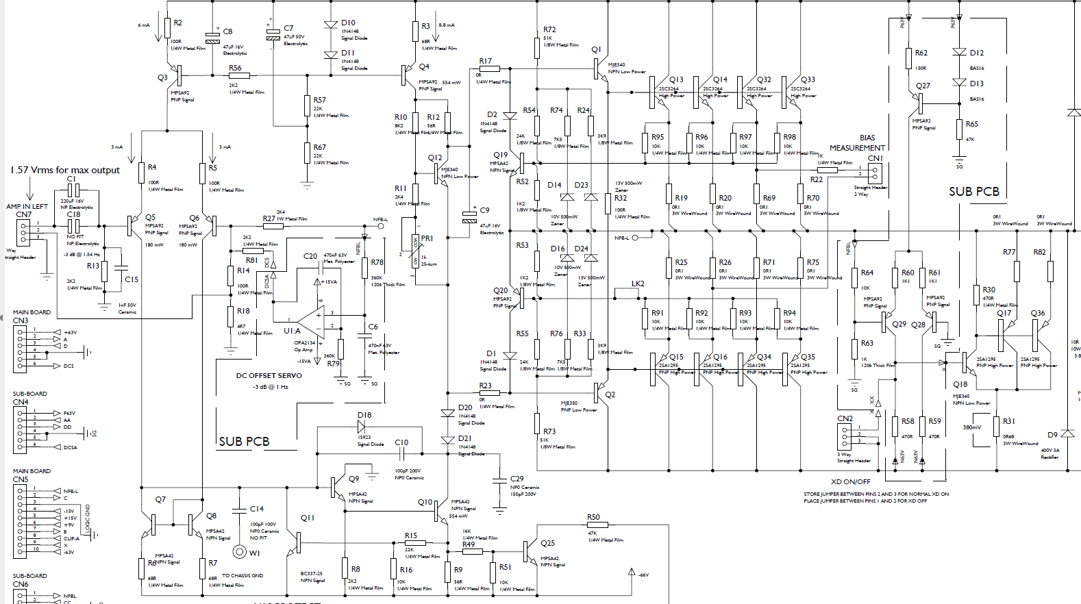

Perhaps it has to do with OPS topology being EF type or CFP type when it comes to 0.1-ohm Re safety-ness. If remembered correctly Cambridge Audio 840A has CFP output stage, so the bias spreader wouldn't care as much about what is going on with individual power transistor Vbe as it would in an EF type OPS.
Nope. Attached is the 840W power amp schematic, is a classic double EF, not a CFP. Bottom right is the switchable class XD stuff. Also note the missing base stoppers, both for the power devices and the drivers. Output devices are 60MHz Sanken pairs. Also, in my opinion, driving 4 Sanken pairs with a MJE340/350 pair as driver is looking for driver SOA trouble.
It's against everything I've ever learned... but apparently it works. WTF do I know?
P.S. Power supply is +/-63V. Spec is 2x200W/8ohm, 2x350W/4ohm, 1x500W/8ohm mono bridged, 1x800W/4ohm mono bridged. Not sure if these watts are sine or "musical", the power supply suggests it's sine, but 800W/4ohm bridged is (IMO) a little bit of a stretch. It means 56Vrms in the 4 ohm load, 78Vpeak or about 20amps in the 4ohm load, 5amps per device. Sanken beta is 50 @ 5A, this is 0.4amps through the driver, add the driver bias and it's very close to the MJE340/350 low frequency Icmax of 0.5A. Looking at the MJE340/350 SOA curves in the data sheet, they cannot survive other than by luck, a kick lower bass will throw them into secondary breakdown.
We'll call this a landmark design which proves the efficacy of Re=0R1 and confound Guru Cordell & other doubters![]()

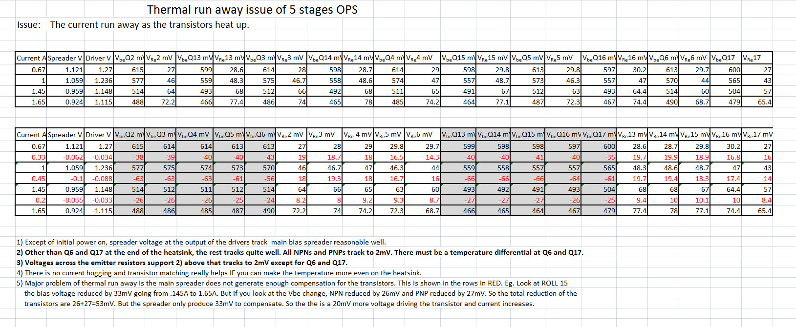

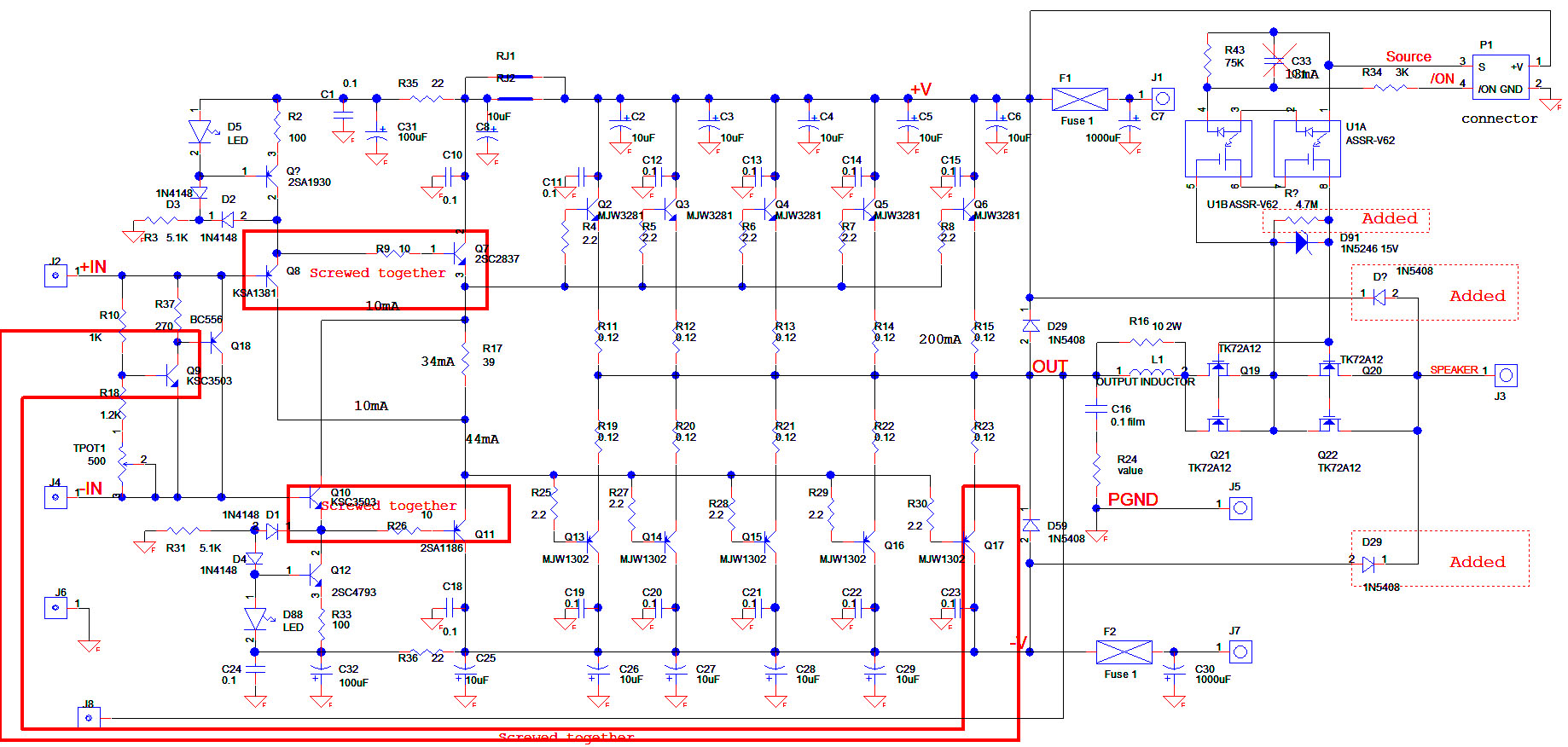

Thermal run away of my OPS
Hi
I powered up my OPS and set the default current. BUT I got into thermal run away as current went from about 0.6A total bias current to over 1.6A as it get hot. I turned it off at that point.
I use +/-31V rail with bench supply. Re=0.22ohm. No load, no IPS/VAS. I just use resistor to pull the bias spreader to +ve and -ve rail to turn the bias spreader to create the bias for the power transistors.
Attached is the JPEG copy of the excel file. The second table is where you want to look at. I am surprised I cannot attach the excel file.
1) First column is the voltage across the main bias spreader.
2) Second column is measure at the output of the driver pair right before the base stop resistors of the power transistor. This is the final voltage after the diamond pre-drivers and main drivers. You can see other than the initial turn on where everything in room temperature, it tracks the main bias spreader quite well.
3) I group the NPN, there voltages across the Re and PNP, there voltages across Re to give good comparison.
This is my analysis:
1) If you look at the Vbe of all NPN and PNP separately, 4 out of 5 track very well to 2mV. The Q6 and Q17 are at the extreme end and I kind of have a fan on even it's not blowing at the heatsink. But it is closer to Q6 and Q7. You can see at first turn on and even at 1A, all Vbe still track very well. Only when it started to run away then Q6 and Q7 start to fall off.
2) There is no current hogging and I contribute this to transistor matching. Even at high temperature, only Q6 and Q17 drop off, the other 4 pairs still sharing the load quite evenly. So absolutely no current hogging. I believe the transistor matching works.
3) The thermal run away is caused by the bias spreader that cannot produce enough compensation voltage for the power transistors. As explained in note #5 in the excel, when current goes from 1.45 to 1.65A, the bias spreader voltage reduced by only 33mV, BUT the Vbe of NPN and PNP together reduced by 53mV. this is where the problem is, that the current increase more and heat up more, and the bias spreader cannot follow even when the thermal coupling is good.
Please Help!!
If you look at the bias spreader voltage, it is only 1.1V instead of traditionally 1.4V. The resistors R10 and R18 for the multipler has to set up in the way you get only about -2mV/deg X(1 +1.1/1.4) and is way less than -4mV/deg C. so the more it heats up, the more it is off.
I don't know how to fix this as this is a diamond, the circuit only want 1.1V!!! I am using KSC3503, only thing I can think of is to change the to a transistor with higher tempco to get back the loss voltage. But transistor?
If anyone see anything in the file, please help me fixing this.

I have been thinking, the only way I can think of is to use a large transistor( or even the MJW1302/3281 for the bias spreader. If you look at the Vbe of those MJW, they are going way below 0.6V, at high temp, it's below 0.5V!!! This make the ratio of the two resistor( R10 and R18) to the point that it's way off the 2XVbe. But the complementary power transistor still have negative tempco of -4mV/deg, the only way is to use a transistor that has low Vbe so I can get more of the multiplier effect to get the tempco of the bias spreader back to -4mV/deg C.
I think I might need to more the bias spreader transistor to the middle of the power transistors to track the higher temperature transistors in the middle also.

Update on the bias spreader issue. I changed the spreader transistor to MJW NPN. I mounted on top of the middle transistor. I ran both 0.75A at 31V rails and 1A at 25V rails. I have been running for almost an hour. The current drop like 10% after I set it. It's getting very hot, not touchable anymore, but it's definitely seems stable. Seems like the choice of the transistor for the bias spreader is the KEY in this.
I have a suspicion if I just mount the MJW on top of Q17 at the end, I will eliminate the dropping of current because it is a little cooler and will eliminate the over compensation and keep the current constant.

...Attached is the 840W power amp schematic...
Also note the output transistors are the nice, low thermal resistance MT200 format.
I assume a similarly nice thermal insulator because it's an upmarket amp and I doubt they skimped.
Then calculated thermal loop return ratio is 0.5 to 0.6, no problem on that aspect.

I think I got it to work changing the spreader transistor from KSC3503 to MJW big NPN. I am surprised I have not read about you have to match Vbe of the spreader with the transistor. From the long table I shown, you can see clearly where the problem lies. I use the MJW as spreader transistor, right now, it seems to work beautifully. It's not that the Vbe is important, it's because you have to set up the multiplier ratio. You need to get 2X -2mV/deg in order to compensate. If the Vbe of the spreader is too high, you have to adjust the resistor ratio so it is no where close to 2X. That's exactly the problem I have.
