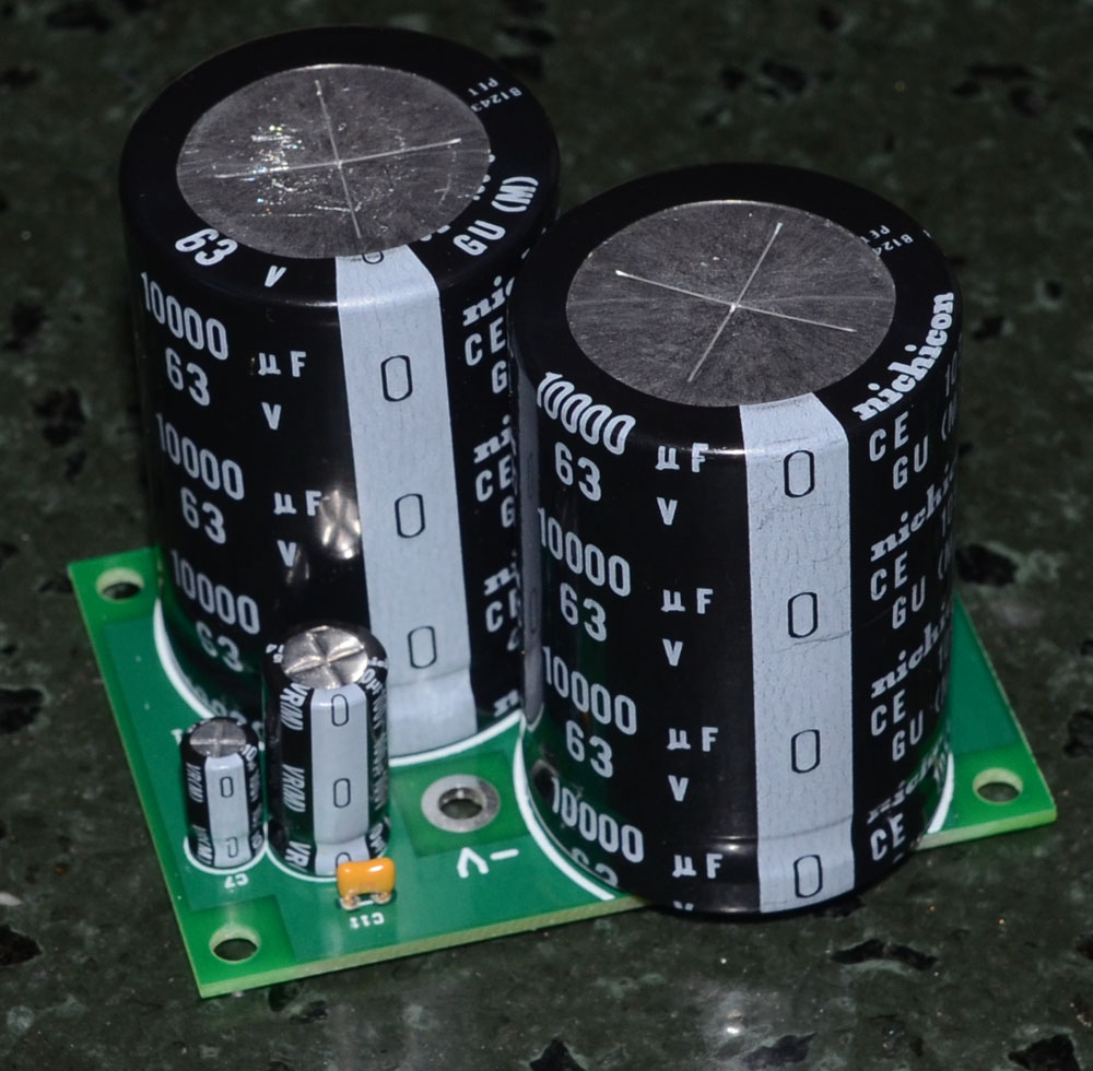

Hi Andrew
Thanks for your detail reply. What is DF?
I have individual pcb holding 2 X 10,000uF 63V, 100uF 100V, 10uF, 100V and 2 X 0.1uF all in parallel for a single rail. This way I make it modualize and scalable so I can put any number of them in parallel to get the amount of capacitance I want. This not only I get scalable capacitance, I have smaller caps in parallel to lower the loss, better frequency response than one or two huge cap.......Not to mention they are cheaper and easier to get.
I might have to consider stacking them up thought as it's taking up space.
I original plan to use 4 of them, one for each rail on each side. I guess I can put more!!

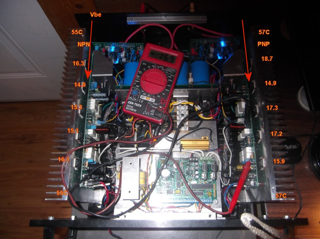

I don't mean to "inject" , Bob. But , some of these issues need the "real world" to be worked out properly.
I'm on one week of operation today. No fires , plenty of loud music.
(below) is the unmatched final worst case scenario. Full power -
Tennessee full heating.
A. Your recommendation of .22Re / 4.7Rb works out (adequately).
I have another amp with 2.2Rb that is a little closer. The lower Rb
shows no deviation from the 4.7 - stability wise.
B. On an EF3 with multiple pairs , this is a big problem with only one
sensor. You could sense those 18.7mv or 16.3mv devices in the picture ,
but they do not behave thermally like the other ones. 40C , they are
nearly the same as the other pairs.
The picture sensors are in the middle of the back four outputs , they
sense the "average" of the rear 2 npn's and 2 PNP's.
When I heated this amp up with real (heavy metal ) , the small
driver extrusion heated in < 1second. It's sensor reacted instantly.
C. This would "boggle the mind" if you tried to work it out with
just pure equations. As an example - the top/bottom C spread of the extrusion
increases between 35C -55C (convection).
D. You might want to examine either an OEM or a sufficiently thought out
DIY design to convey these points. Many of the other DIY projects
on this forum are ignoring these issues , as well as other electrical layout
issues.
PS - by what I'm doing now , I quite sure "it's all worked out" (20+ years
of reliable operation) - before re-capping !!
OS

But if you are running between 14mV to 16mV on the 0.22ohm Re, you are not running very high power at idle. I calculated you are running about 70mA per stage and 350mA total. Assume 160V across total, that's dissipating 56W for the whole amp at idle, as this it mono far as I can see. You have a lot of heat sink for 56W.
I was just measuring the exposed semi's in a "natural" vertical orientation.
There are two complete AB amps in there. You calculated right , I estimated
>50w per channel.
I'm 144V (not 160).
Alan , I'm the opposite - build it first , then fix it .
Last version favored the middle pairs with abuse. This one is perfect
considering stock unmatched devices.
Edit - those temps. were after I "abused " it.
OS

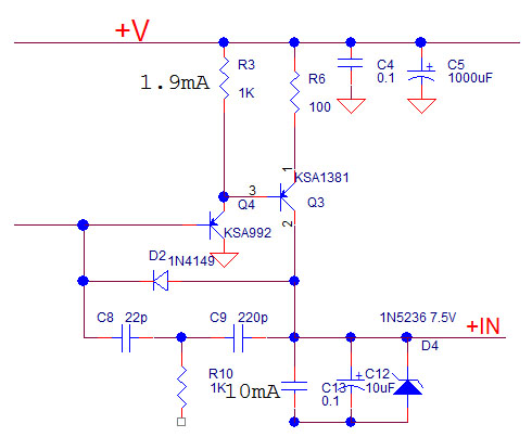

Hi Mr. Cordell
This is a completely new topic.
I was reading Feedback Baker Clamp in p367 which I never read before, it got me worry. I put in my anti stick circuit automatically when I design the IPS/VAS board. I just used the standard technique of Schottky TTL idea of using the diode D2 to clamp the base current as shown in the attachment.
When I read your book this morning, I was thinking how come you don't do it like mine as it's so simple. Then I realize I am doing it on the Miller feedback path. I am using 1N4149 with 1pF capacitance. But it is known the reverse diode capacitance change with reverse voltage. This mean I am changing the capacitance a little as the output swing that can cause distortion.
My question to you is whether this is too much that I need to change it? As you can see, I am using TMC with smaller cap 18pF on my board. Is this large enough to swamp out the variation of capacitance of the diode? If I have to modify, this might cause big problem to modify as I don't have a place to clamp to. In Figl 17.3, you use Q11 and Q12 to set up the voltage to clamp to and I don't have it. Please help!!!
Alan

The nonlinear capacitance of your diode is the reason why this type of diode feedback arrangement is not generally used to prevent saturation of the VAS transistor, so it is a concern. I think most amps just let the VAS saturate in clipping. Pick your poison.
BTW, the 2T Darlington VAS brings with it the advantage that the Ccb of the main VAS transistor is not allowed to be fed back to the input of the 2T VAS, so the effect of the nonlinear Ccb of the VAS transistor is nearly eliminated.

Ha ha, not the answer I am looking for from you. I thought you are all comforting!!
Now what!!! I don't like it to stick. It was so obvious at the time that I totally missed the moon. Got so automatic in prevent the clipping I put it in without even gave it a thought until I read your book today.
