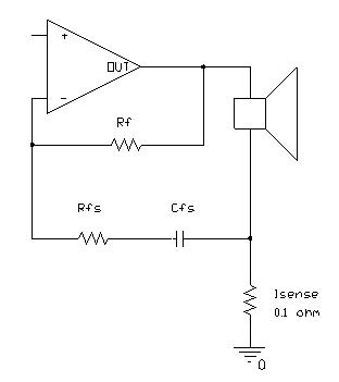

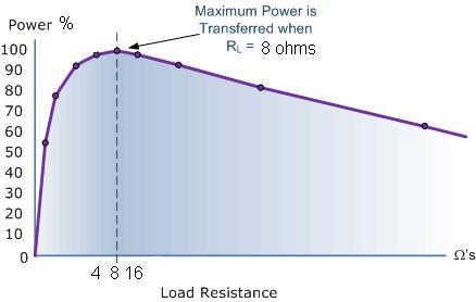

Something I played around with about ten years ago was a mixed mode voltage current feedback arrangement. This is a simple mod that can be done with any power amplifier.
I must add that it can cause stability problems and is not for the inexperienced hobbyist.
With this arrangement the gain of the amplifier is altered by the load impedance. The gain of the amplifier is reduced with an increase of load impedance say from 8 to 4 ohms and vice-versa. The gain is fixed to a maximum by the ratio of the feedback components and the minimum gain is unity. The gain of the amplifier and output power to the load follow the impedance curve of the speaker. I found that the output power of the amplifier very nearly matched that of a maximum power transfer curve.
It did cause some minor bursts of oscillation in the crests and troughs of a sine wave at higher output power levels but I think this could be over come by some minor tweaks to the amplifier's compensation.
I didn't pursue this any further because a lack of test equipment at the time, but the sonic results make it well worth looking into. There was both a high and low frequency extension and a thickening of the mid-range in a very pleasing way. It may be a reasonable alternative to a pure voltage or current drive.
Below is an illustration of the basic form.
David.
