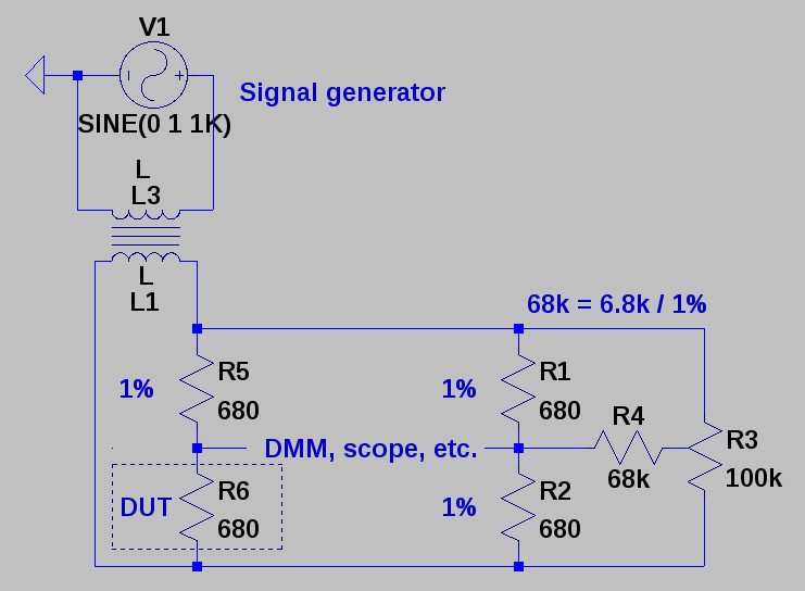

This is what I'm envisioning. Yes, R3 is a trimmer.

Danbridge (of Denmark) makes several passive component analyzers such as the CLT10, using a 10kHz sine wave and a 30 kHz bandpass voltmeter. I think the noise floor is something like -150 db, but can be pushed down to -170 db under certain conditions. It's been a while, but I found online application notes about testing both resistors and capacitors, and it's designed for both lab and production quality control.
danbridge
Needless to say, I can't afford it. Maybe I can cobble together a Wheatstone bridge and use it with my Tektronix AA-501 test set, which seems to have a distortion floor of around .001%.
You can put a trimmer across the reference resistors to trim out the residual. If the resistors are all 1% or so, then the trimmer will only contribute no more than 1% or so of the result. So if the trimmer THD is say 0.0005%, the contribution would be something like <0.000005%.
With this method you don't necessarily need a low-distortion input signal either, since when the residual is isolated, it can only be harmonics of the input signal and it's harmonics. So if you want your result to be within say 20%, then 20%THD is in fact acceptable for an input signal as long as the harmonics don't disrupt the measurement equipment.
This means you could couple your SG to the input through a signal transformer to have an isolated measurement so you wouldn't need a differential amplifier to measure the result.
I'm not sure about this, but at any rate, Conrad Hoffman shows what can be done with a good bridge setup:
Measured Differences Between Capacitors for Audio Applications
These are very good points, especially about virtually eliminating the distortion of the generator as a factor. This is something that I have always liked about the operation of my Distortion Magnifier as well. Mitigating the contribution of the generator makes it possible to more easily get higher-voltage sources, like 40V rms, that would better reveal the resistor voltage distortions.
Not sure I would want to go the transformer route, but I'm guessing that a carefully-built differential amplifier could be made to do the job - perhaps a 3 op amp instrumentation amplifier built with LM4562 or the like.
I would still view the output of the bridge arrangement on a spectrum analyzer.

As you said, it is important to use higher voltages to reveal the existance or non existance of this non linearity and quantify it.
My inclination is to make each branch an attenuator of about 10:1 or 11:1, so the input resistors would be 6800 ohms, for example. This allows larger voltages to be applied to the resistors without incurring large common-mode voltages. It also lightens the load on the source. Using a spectrum analyzer with a very small bandwidth helps with the noise. In one of my tests, I have the HP 3580A zoomed in to 3kHz with a 1Hz bandwidth. It is covering 100Hz per division and sweeping at 100 seconds per division.

Why using this convoluted and obsolete way of measuring low distortions, and not directly a good soundcard that may show -130dB (or even better) distortions if used in balanced mode?
This is a good point if it works well enough, and I encourage you or others to do a similar set of tests that way to confirm my findings. I just chose to do it this way. To each his own if it works. Improvements are always appreciated.
Instead of criticism of the methodology, I'm more interested in your constructive and insightful comments on the results.

Hi Waly,
PS, in my current setup, zoomed in on 3kHz with 1Hz bandwidth, the carbon film resistor with 4V across it is coming in at -133dB and my measurement floor is -140dB, all of which is noise in the 3kHz region.

If your instrument/sound card has residual distortions (for whatever reason) larger than the DUT, then don't use it for measurements, period.
Sound cards are not intended as measuring instruments, so complaints about -120dB distortion residuals should be directed to /dev/null. -140dB residual is (more or less) a lucky bonus, not a requirement for a sound card, even for an expensive one.
So resistor distortion, even for supposedly of the worst kind, is way, way overrated, not a big surprise. Don't forget to mention this to Mr. simon7000 and to all those paying obscene amounts for Vishay Bulk naked metal foil resistors, for the use in audio.
