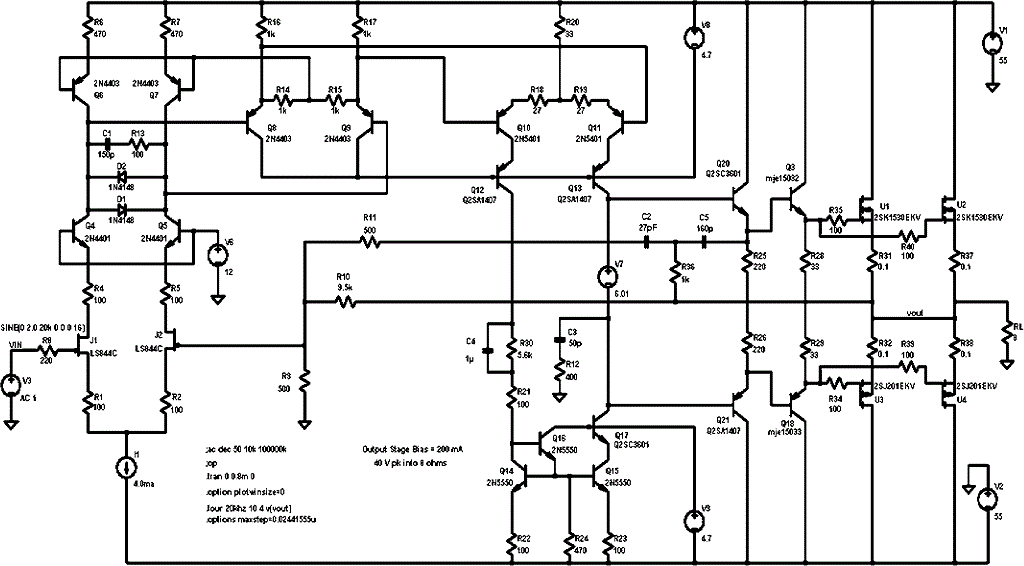

Hi Bob,
I'm very interested in Fig 11.17 (page 242) - high performance MOSFET amplifier.
I have some questions i want to ask you:
- R21 (100R), why the schematic have R21. The value of R21 is smallest more than R20 (5K6).
The Iin through R20, R21 and they're balanced with Iout by a cascoded with ''helper'' transistor current mirror. Can i change R20, R21 by a PNP medium power trans?! Like 2SA1407, 2SA1381... I think the transistor will set a dynamic impedance Zce, better than a fixed resistors.
- The schematic look like simulation. Have you try to do it, in real life? And if you're did, are they good?! Please take to me more some info. The Iin & Iout have a balance?!
I have some problem with current mirror ''helper'' trans, the Iin & Iout are not true balance (5.6mA for Iin, and 5.9mA for Iout)
I have a plan to do project like this, but simpler. With Hawskford cascode Vas, is the current mirror need cascoded?! Please give me advice, i'm trying to keep the circuit is simple.
Thank you!!!
