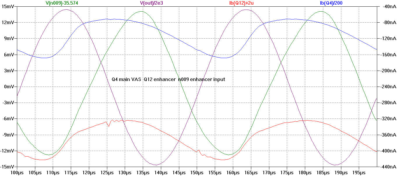

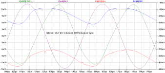

Ib(Q4) & (Q12) are base currents of main VAS & enhancer respectively. As kean suggests, they mostly reflect each other with suitable scaling.
Please note the scaling & arithmetic to get all da plots on the same axes for comparison
But they also show AT THAT POINT, both enhancer and main VAS are mostly VOLTAGE driven. V(n009) is the input to the enhancer which is sorta 'undistorted'.
This is Blameless6 from my #4008 post. 20Vrms 8R 20kHz
If you do the same with the simple Blameless11 circuit with single device BJT, the situation is reversed. Ib(Q4) is sorta undistorted while its base voltage shows the usual Vbe distortion of a CE stage giving clean output current. (looking very like the base currents in Blameless6 in fact)
Here the IPS/CM output is MUCH higher Z than the VAS input so current drive is an 'accurate' description. That makes it MUCH more susceptible to evil VAS Ccb modulation.
With the enhancer in Blameless6, neither enhancer or main VAS are 'purely' voltage or current driven. My example shows more voltage than current but my original assertion that both IPS/CM output Z & VAS input Z are in the same ballpark is probably the best description.
Change of enhancer device, emitter resistor etc can easily swing things slightly to one or the other, making the VAS more or less susceptible to Ccb modulation. But its always less susceptible than Blameless11 when you compensate for Loop Gain and operate at nearly Open Loop as I have done cos 'much more' voltage driven.

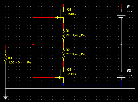

I simmed the following circuit, & used the Jfets shown as i didn't have the ones you did !
Anyway, i found that Without R4 THD @ 1kHz reduced to 0.001% from 0.002%. Increasing the Supply to +- 22V made a Massive difference, as you showed
