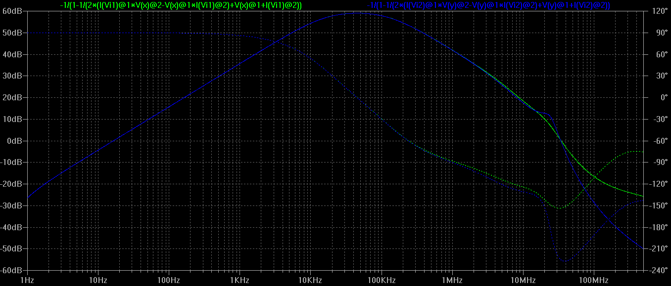

Well, it's not mine... an amplifier that has a some 47 degrees phase margin. Try to bias the output towards the rails, and note the phase margin going to 20-25 degrees. For anything else but simulation purposes, that's in my book a pathological design.
Yes...and? I posted a Bode plot that clearly shows non minimum phase behaviour. I linked to the schematic and LTspice file so anyone who doubts the result can check the circuit and models. What's the problem?Secondly, you posted a simulation result, and a link to a schematic and the LTSpice file.
Yes. I had not "worked out the details" of why the non-minimum phase behaviour was so conspicuous. Doesn't alter the fact it is a clear case of non-minimum phase behaviour. I added a capacitor across the VAS emitter resistor. The models are all in the linked post.You also mentioned "I haven't worked out the details", so please do, mention clearly what changes you did in the original schematics, what models you are using...
Meantime, your example doesn't prove that "audio amplifiers are non-minimum phase system", but only that "all amplifiers have RHP zeroes".
RHP zeroes in the forward transfer function lead to non-minimum phase behaviour.
The Miller feedback can have the RHP zero eliminated with a series resistor.Following your logic, all amplifiers are non-minimum phase, simply because all active devices have some sort of Miller feedback
But all amplifiers are ultimately non-minimum phase. The only question is whether that behaviour is of practical importance.

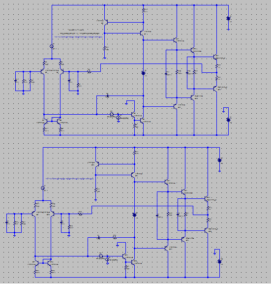

Frequency response with 250r and 1k buffer output load.
100pF VAS/TIS loading is absent when simulating with 1k.
On what basis do you make the assumption that the miniscule variations in closed loop frequency response at HF are due to TIS loading?
Alternatively, the TIS's positive zero can be made to migrate to the LHP by using an appropriately sized resistor in series with the Miller compensation capacitor. Note that if the resistor is too large, then it may increase the unity loop gain frequency, which, taken together with non-dominant sigularities, may again compromise stability margins.
Note that connecting a resistor in series with the Miller capacitor seems to worsen the stability margins of the minor loop.

... a resistor in series with the Miller capacitor seems to worsen the stability ... of the minor loop.
I had not considered that, and I don't think I have seen it mentioned before.
You Spiced this?

Yes. See below.I had not considered that, and I don't think I have seen it mentioned before.
You Spiced this?
Best wishes
David.
Minor loop gain phase shift (Green trace) at unity gain without series resistor=153 degrees
Minor loop gain phase shift (Blue trace) at unity gain with 100R series resistor=225 degrees

Yes, seems reasonable, but sometimes this non-minimum phase behaviour is not intuitive.
Yes. See below.
