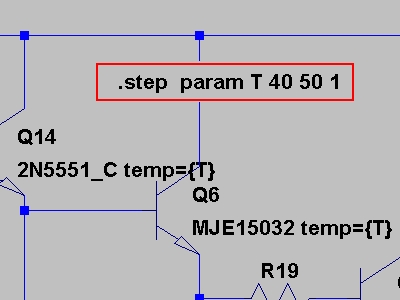

No, I'm not forgetting the transistor compensation the VBE multiplier, I do not know if you know this feature in spice, locking all transistors/diodes in a fixed temperature. I lock all transistors for the temperature internal of case, only the output transistors and transistor sensor VBE are unlocked.
I forgot to mention in the previous topic, in my circuit use a triple output (T), pre drives and drives will not in heatsink.
Doing some simulations, found that the culprits by changing the bias current is the change of VBE pre-drives and drives, an increase of only 5°C you will have an increase of 30% in bias current of output transistors.
The circuit in Figure is my VBE multiplier for a triple (T), as I am not using ThermalTrak the circuit set for over-compensating in 10°C (40%), this difference in temperature between the transistor output and monitor VBE mounted on heatsink, this according to book D.Self (3 edition).

My question is how do you set the temperature rise over time unless you are actually measuring it in real time? I understand how you can figure the numbers from a data sheet and see the changes but how do you correlate that to room temperatures? It obviously is not directly tied to room temperature as the device temperature will not follow room temperature changes and a rise of 10 degrees C room temp.does not mean that you will have a similar rise in device temperature?
I answered my own question.
.step param tmp LIST 20 25 30 35 40 45 50 55 65
BC557C temp = {tmp}
This can be repeated for any number of transistors or other components.
One can leave the global temp set and temperature sweep selected components.

I noticed that in the simulation,variation of temperature in LTP and VAS is little significant change to the bias of the output transistors. You're right, two heatsinks and two vbe multiplier solve the problem, think you used TO-126 for pre-drives.One of my favorite approaches is to use two transistors in the bias spreader. One on the heatsink and one on a board-mounted heat spreader bar onto which are also mounted the pre-drivers and drivers.

I too did, but simple see the 1 figure.

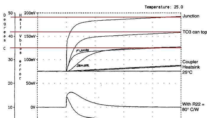

Do do not forget if you do not use ThermalTrak (see figure 2) should over-compensate the vbe multiplier. I use transistors TO-3P they do not have to tab metallic for put transistor/sensor, I put the transistor in the heatsink and use the 3 line of graph (12°C over-compensate).

Even if you have perfect thermal contact, it takes time for the short-term power dependent temp changes to get from the die to the outside world.
See attached. Perfect thermal stability (long term), still what some would call 'thermal memory'.

Nice picture;
This is true for any kind of Vbe multiplier.
