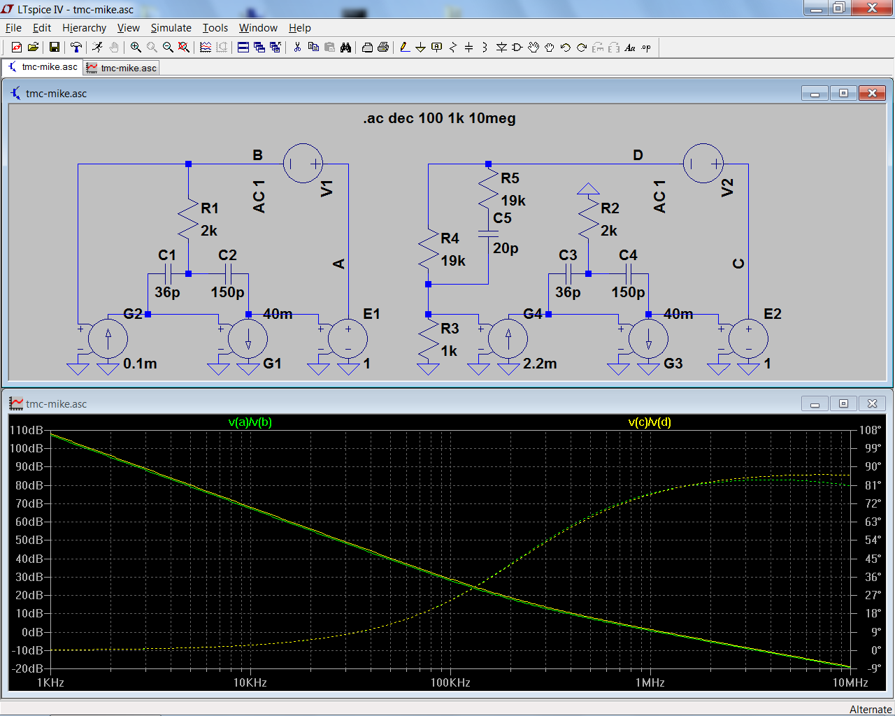

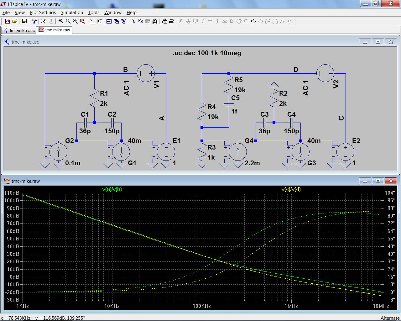

are we speaking about something like this? On the right-hand sides (TPC), I have set the input transconductance a bit too high, so that magnitude curves remain slightly different. The second picture is effectively without lead network.
Edit:
Just became aware that I didn't check whether the poles coincide. Very probably, they don't.
BR,
Matze
Bob,
To have an apples and apples comparison of "TMC" versus TPC you MUST have the same unity loop gain frequency and loop gain at all frequencies of interest about the second stage and the output stage.
This means the minor loop gain with "TMC" and the major loop gain with TPC must have the same locations for the coincident poles and the zero restoring a single pole roll-off.
This is common sense; these criteria are, self evidently, not arbitrary at all and can ONLY be met by using the same component values when comparing "TMC" and TPC.
Now, can you DEMONSTRATE that these criteria can be met using component values that are different with "TMC" viz a viz TPC?
Hi Mike,
Apples apples only requires the same amount of stability around the minor loop, in terms of phase and gain margin, in a real amplifier. This can be achieved in numerous ways. Moreover, it can be a function of the real amplifier. If you simulate some real amplifiers, and at the same time look at the gain and phase margins of the total loop gain enclosing the output stage, you will get a better understanding of this.
It is also important that you recognize that and apples-apples comparison between TMC and TPC must be done without your lead network.

An apples and apples comparison requires that you have the same loop gain about the minor loop with "TMC" as you would have about the whole amplifier with TPC.
In addition you need the same stability margins, which requires the same pole location and the same zero location; there are no "numerous ways" of doing this: you need to have the same component values in both cases.
The lead network isn't necessary to demonstrate this fact. So I think your invoking it is a red herring.

Michael, I'm sorry, but you are completely wrong. TMC is not equivalent to TPC without the lead-lag network.
I'm suspecting you have a distorted and fuzzy definition of "TMC is simply TPC localised to the second stage and the output stage". Conceptually, you could be right (after all, TMC and TPC are both methods of 2nd order compensation) but the devil is in the details, so please explain what exactly "TMC is simply TPC localised to the second stage and the output stage" means. Using numbers is fine.
