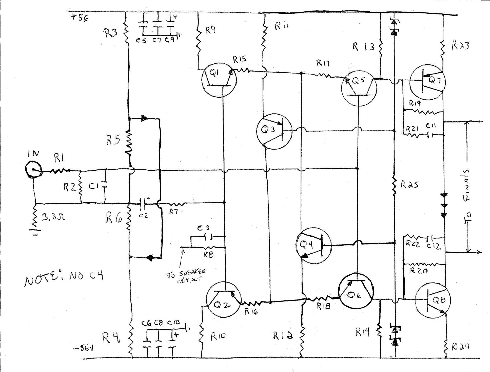

amp bias pot
I've learned there a lot of very sharp amp builders following this thread. would one you take a stab at how-to & where put a bias pot on the attachment?
I developed the drawing studying the driver boards many hours. I can post a parts list if necessary.
Thanks in advance for your help, Tony

Well you can put a bias pot in series with the diode bias string. But why not use a transistor bias spreader instead?
David.
