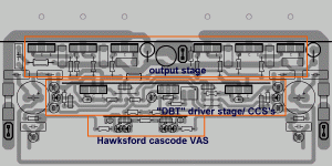

First you have to do that with the prototype. Then try to go "minimalist" with any of the building blocks, trying hard to make the right compromises in the performance vs. parts count arena. So you start at "simulate" again to make the final version (it's also nice to have the working prototype to confirm) , then you have to do something that only experience can define .. layout (below).
For DIY , one might not want to overwhelm the builder (121 parts is enough) , an OEM can make a 200mm X 400mm main board and trim the parasitic's after the fact (lucky them !) , 600 parts w . daughterboards is not uncommon.
PS - that's what the final "DBT" will be ( below). MUCH harder than a EF2 or Lateral OP.
OS
by .B Cordell - I believe, design, simulate, build, listen, iterate.
And they are easier to refine , layout , thermally compensate. Most are lower power class A or bootstrapped LIN AB's ... hard to go wrong. For 120v p-p with acceptable or excellent linearity , you have to throw a few more parts in there.by .B Cordell -there are many good-sounding minimalist designs out there
