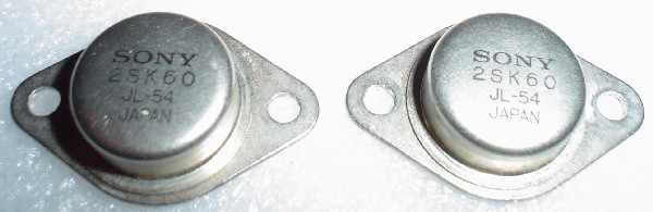

The collectors bug has been bothering me again lately, today received some more Sony VFETs and Hitachi 2SJ50/2SK135s from the mailman. ($2/pc. D..., i'm so good i feel like scavenging the beach tonight)
A few more of the same class VFETs, and i have enough to rebuild the Marantz class A MA-24 schematic for depletion mode devices. For a circuit/parts like that the Jensen caps might be a nice addition.

there's an electronics store in France that sells Sony V-FETs, but the ticket is $25/pc.
I'm finding them by the piece or in small batches everywhere, both used and NOS. Downside of course is that it takes a lot of patience to collect enough of the same Vp type.

> where did you find Sony vfets?
I used to have a source who had some 20 odd Sony VFETs (2SK60) of the same ranking, and he was kind enough to send me the lot for measurement.
Apparently, after years of ageing, they are not that well matched anymore (both in Vgs and in transcondyuctance). In the end, I returned the lot and just bought one as a museum piece.
I then got some Loveltech JFETs from Grey Rollins and measured them together with a cascode (2SK1529). They are, IMHO, just as good if not better in every aspect. The only penalty is that you burn a few volts because of the cascode. But there are enough supply of devices around and one can also change the cascode device to change the load line, (almost) independent of speaker impedance. So I would not hesistate to recommend to anyone to consider that approach. Thanks Nelson for the tipp.
