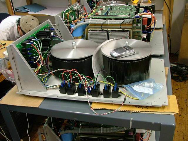

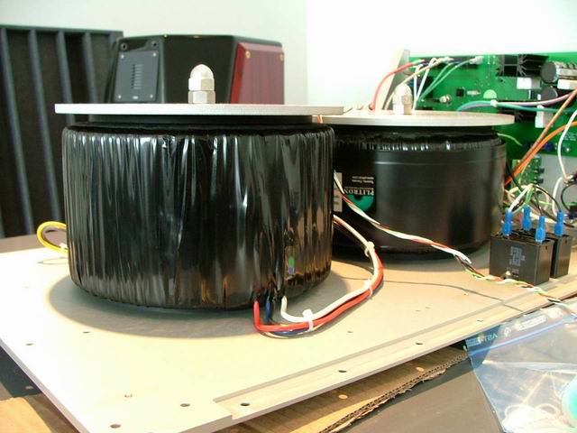

Interestingly, Viola Audio Labs still uses choke input filters in the power supplies of their pre- and power amps. Quote: “The Bravo uses a choke input filter type power supply with a generously rated 2kVA mains transformer. Four 80,000μF filter capacitors are located in the power amplifier chassis to provide optimum power supply decoupling. The Bravo's choke input filter design power supply produces far less Electro-Magnetic Interference than the capacitor input designs most commonly used in power amplifiers. “
In the past, Cello audio used choke input filters and I believe an earlier model of an Ayre power amplifier also had them. I have a couple of pictures of the power supply of the Viola Bravo power amplifier but for some reason I can’t upload them.
