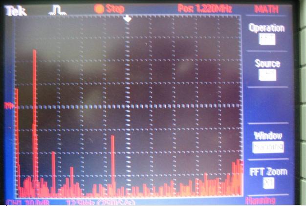

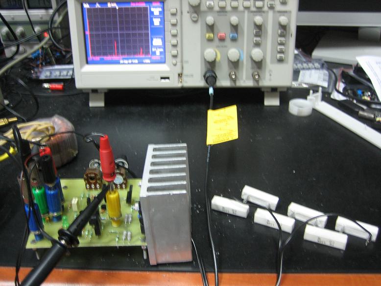

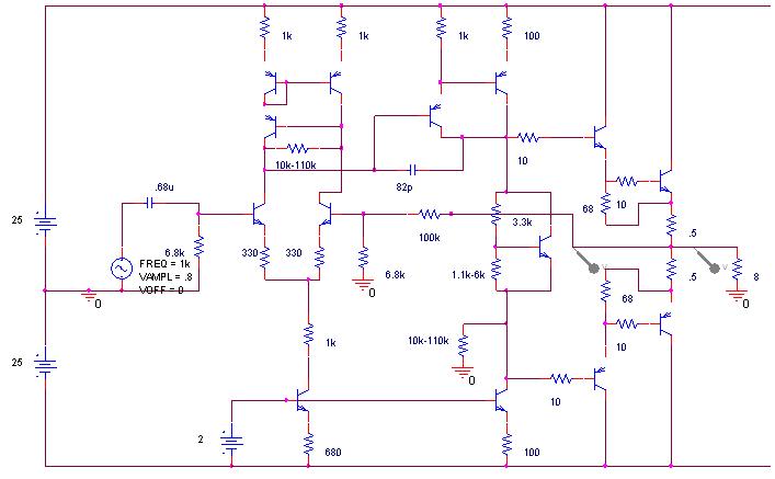

I have made some measurements on crossover distortion versus feedback factor at DC. I have 2 pots, one adjusting bias and the other adjusting feedback factor going from 35dB at DC and reasonably flat on audio range and 60dB at DC with low open loop bandwidth.
Edit: more on feedback pot: it is actually a stereo log 100K pot in series with resistors. It adjusts resistive loading of LTP and VAS going from less than 10k to some 115k (cheap pot). Gain-bandwidth product remains nearly the same when adjusting feedback, just dominant pole frequency changes.
Schematic:
Schematic:

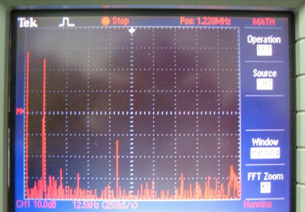

8bit, 10dB/div, I guess distortion products are not below dynamic range.PMA said:Hi Adam,
what is the scope A/D resolution in bits? And Y axis is 10dB/div ?
So the result for 60dB FB was about 5dB worse than that for 40dB FB?
[/B]
It looks exactly like this. Keep in mind that 10kHz is already higher than open loop bandwidth in both cases and in both cases FB at 10kHz is probably around 25dB. FB at low frequency is 60dB and 40dB.
regards
darkfenriz said:Keep in mind that 10kHz is already higher than open loop bandwidth in both cases and in both cases FB at 10kHz is probably around 25dB. FB at low frequency is 60dB and 40dB.
regards
I keep it in mind, that's why the results are interesting, it is close to many real world designs.

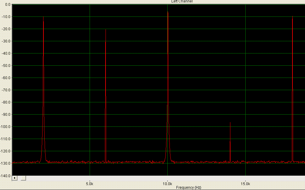

PMA said:Adam,
though I cannot attach the image, I have my web:
<image removed by moderating team>
Pavel,
Nice plot. Is this a SPICE simulation?
How much NFB was in place at dc here?
Thanks!
Bob
