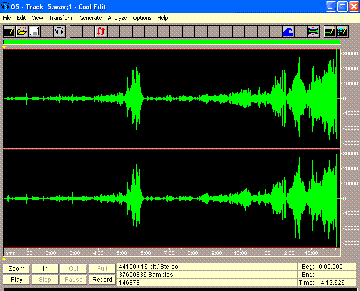

You have obviously never listened to Rickie Lee Jones' "Ghetto of my Mind" in a situation where you can capture and read out in real time the transient levels going into the speaker. That is why you should have come to our audio workshops. Go to my site at www.cordellaudio.com and read the workshop summary for that work shop.
The people who attended dropped their jaws when they listened to it and saw the peak power levels and realized that the sound level was not driving them out of the room (a hotel room, no less). The speakers we were using were about 85 dB SPL and we were clipping a 250 wpc big amp (not wimpy) on the snare drum thwaks. This is easily demonstrated using the Peak-Average meter I developed for this purpose. Crest factor on well-recorded music can really get you. I'm surprised that you don't seem to understand this. On the other hand, we certainly don't see as much of that kind of music around as we would like, so maybe you just haven't come across any lately.
I am certainly in the bigger amp, higher current camp, but even those will sometimes clip.
