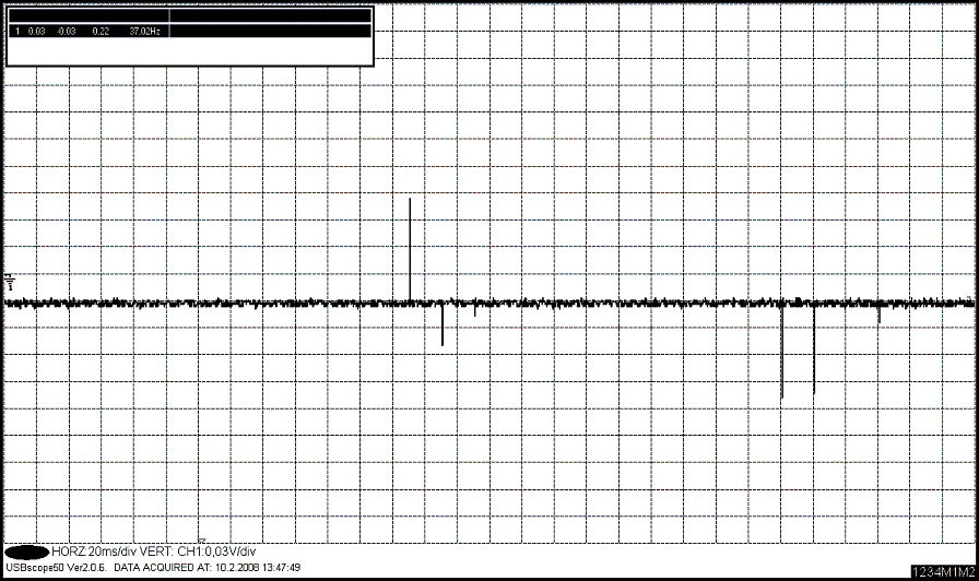

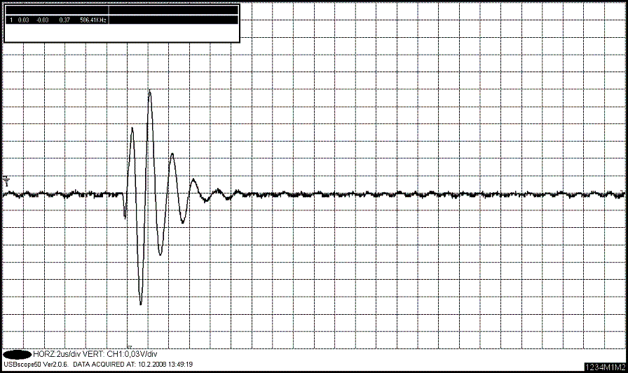

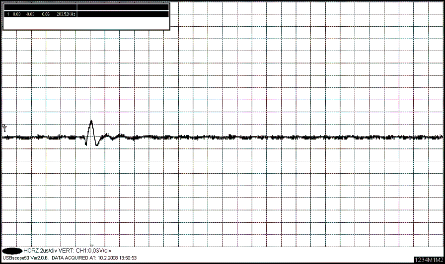

janneman said:that there are transparent switches
Well, a small example of a SMALL discontinuity in shielding, just like several cm of wire behind chassis insulated connector
salas said:It does sound different all the time if something is not exactly the same. And yes, I agree. 'Necessary but not sufficient' is a good sum up.
Don't you accept that it might be possible to make a change to your system and not hear a difference?
Jan Didden
PMA said:The same in detail.
The same for shielding without discontinuity.
