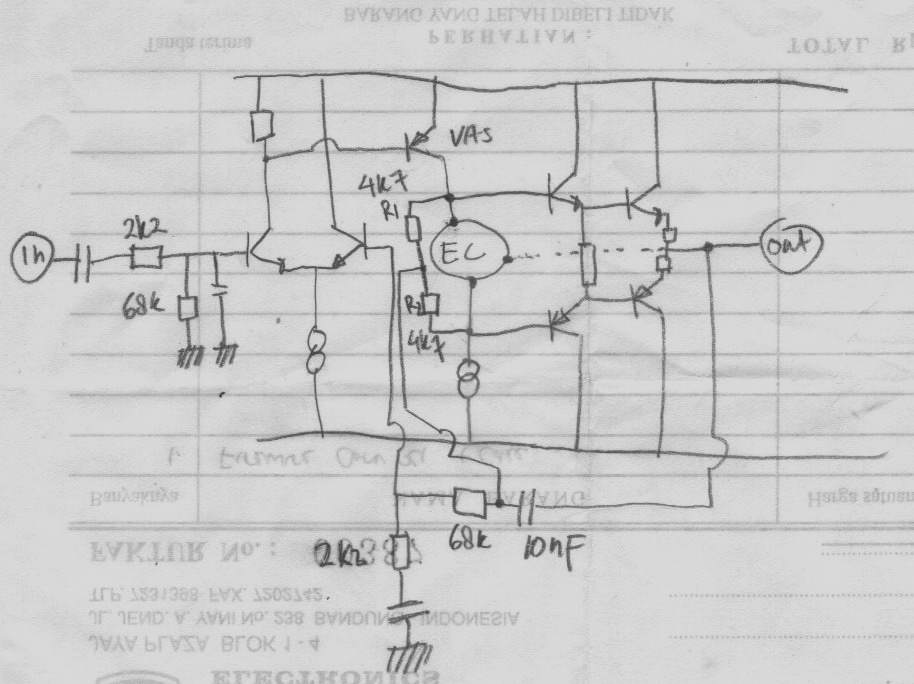

Mr. Cordell,
Since EC is capable of running the output stage openloop, I tried some experiment to exploit the capability of this EC output stage.
I make this. It sounds like tube (actually I don't like the term "tube sounded solid state", since we still can buy tubes (not that rare or expensive), why should imitate tubesound with solidstate? Want tube sound, well......make tube amp )
The idea is this. In global feedback power amp, the OL gain (thus the feedback) is falling towards frequency. In lower frequency there are lot of gain to be burned in feedback, but in higher frequency, the gain is not there anymore, high frequencies have less feedback than lower frequencies).
I make the DC feedback taken from VAS (via 2x4k7). But I put another 10nF from output node. I hope this way the amp will have more feedback loop only at high frequencies where naturally they are falling.
The sound is nice It has tube sound mid-low (because output stage is openloop at mid-low), but the highs are controlled well. Maybe chaotic in measurement result, but it is a nice sounding combination

This is an interesting circuit, but I'm not sure what the advantage is of depriving the output stage of the extra NFB at low frequencies.
I think the biggest reason not to make tube amps is the cost.. no the heat... no the bulk...no the tube life ...
I could make a solid state amp that sounded like a tube amp (just like Carver did years ago), but visually it would lack that warm glow.
Bob
Its an experiment, what will the sound like, if we use more feedback at higher frequencies (where naturally they are falling).This is an interesting circuit, but I'm not sure what the advantage is of depriving the output stage of the extra NFB at low frequencies.
