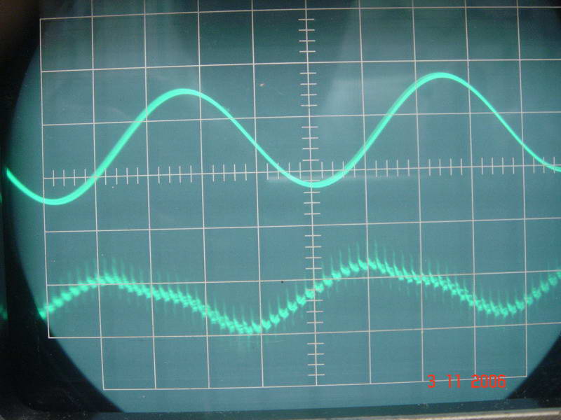

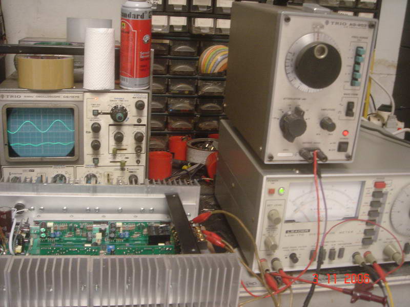

I maybe making mistake back then, because I also don't believe it. But it appears different between different RCA females.RCA f-jack scope noise: nonsense.
The setup is : Female RCA, the most obvious one is the comparison between plastic-cased cheap RCA and full brass expensive RCA.
RCA is connected to preamp input. Turn the volume to max, attach to amplifier, see the output of the amp in osciloscope. The female RCA is not connected to anything.
The distoriton (noise?) has different shape, only because I changed the female RCA (while nothing is attached to it).

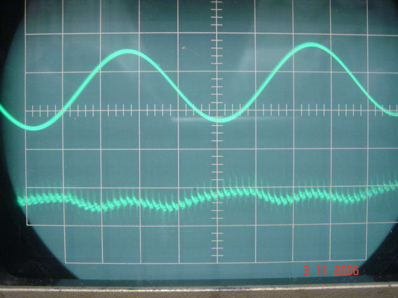

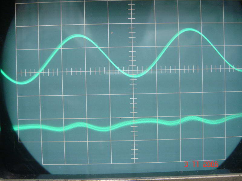

It seems speaker cables are picking noise, and it gets into the feedback system from the power amp's binding post. There are spikes appear on the distoriton artifact when the speaker cables are attached to the amp's output, whether the load is dummy load or speaker.
lumanauw said:Those spikes are >20khz. I think this is the one who makes the reproduction becomes "harsh". It will not change guitar sound to piano sound but guitar sound to "harsh" guitar sound
For piano sound distortions must be asymmetrical and their spectral distribution should depend on force of impact. Harsh distortions are symmetrical distortions of high order that are brighter on lower volumes.
Hi, PMA,
I just know a difference between connecting/not connecting speaker wire (+load) to amplifier output binding post.
The output itself shows no difference at all (between connecting/not connecting), even if we magnifies the output trace alot.
But after nulling, there is the difference. It is not proportional between upper and lower screen, the lower has much bigger magnification than the upper.
What is that?, but you will have to learn a lot to distinguish between signal content and coupled interference influence on your measurements.
