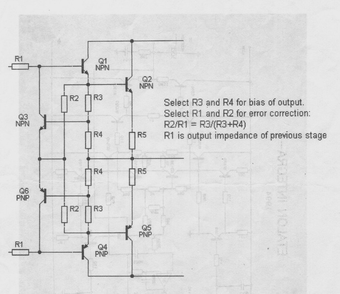

Hi, AndyC,
Sorry, I really don't know if it was you who wrote it :D
This is the Hawksford equation, R2/R1=R3/(R3+R4)

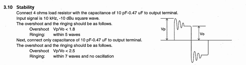

I wonder why people always test with stability towards 2uF capacitor? Where does this test coming from?
This is a setup procedure for professional amp. It only uses 0.47uF max and still allows ringing.
I think this comes from the original Quad electrostatic speakers from long ago. They supposedly looked like 2uF. I don't know if this is actually true though.
When there is an output inductor, the ringing in that test is not from instability, but from the L and C creating an underdamped passive circuit.

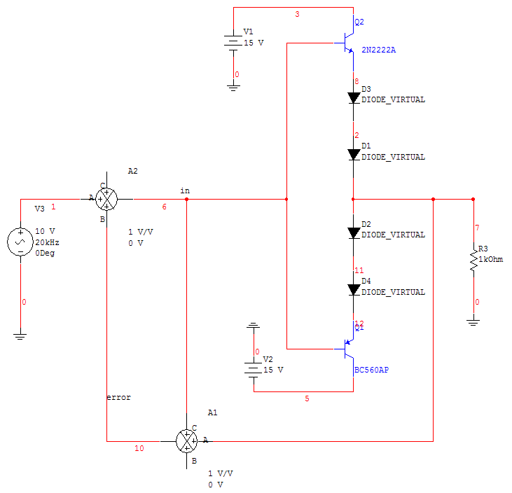

Block diagram summers can easily be implemented in any spice with Voltage Dependant Voltage Sources
It can however be a really bad idea
It is easy to create this "infinite gain" situation that is completely non-physical
(try changing E1 gain to 0.999999 or 1.000001, then you get -/+ 1e6 Av with flat phase shift)
This is a big move backwards in trying to understand the real circuit's properties
All such summers must be implemented with real, causual transfer functions that have high frequency roll off and phase shift to avoid completely unreal gains from positive feedbacks
gains which are hidden by the innocuous seeming gain 1 block (“watch the fingers folks, see nothing up my sleeves… just these little unity gain summers…”)
Re: Bad Mike!

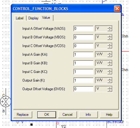

Actually, the bespoke summers in Multisim are ideal in all respects-similar to those in Matlab-, and used here to merely demonstrate that the product of the summers gains must be unity for error cancellation.
Incidentally, the 0.000006% THD result is the residual in Multisim, so 100% cancellation is possible in principal, at least in the audio-band, which is all that matters.

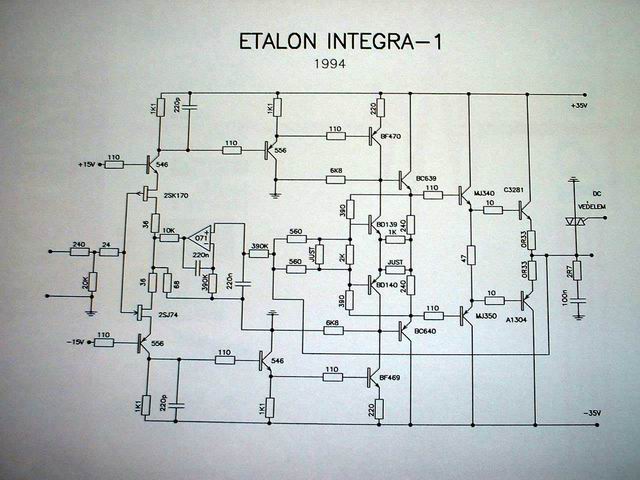

lumanauw said:
how come in this schematic, the EC don't have R1?
Is this means this Etalon schematic is not using EC?
Resistor R1 here is used to define the gain in the error loop.
Notice that the later is accomplished in Etalon by resistively loading the second stage-a similar approach is used by Yokoyama, referred to earlier in the thread.
Re: Re: Bad Mike!
No Mike, “what matters” is the implication that zero phase/gain summers can inform us of the inherent performance limitations of a physical circuit
You can establish the ideal condition which shows the behavior pointed to by math that only uses real number arithmetic instead of the complex number math that more closely represents the real world finite bandwidth circuitry
No physical realization of linear error correction can “beat” the performance limits imposed by the finite gain-bandwidth of the circuitry
If for instance we have 20 MHz single pole ”unity gain” summer circuit then its accuracy at 20 KHz is 1/1000 and it is therefore not capable of “100% cancellation in principle"
Hi Julian,
The summers used are ideal, and were used to demonstrate the principal that error can in fact be cancelled by error feedback in principal without infinite loop transmission, contrary to Lipshitz/Vanderkooy.
Of course i am aware that an ''ideal summer'' possesses flat bandwidth from DC to light, and that the summers used in a practical implementation have bandwidth limitations, and generate distortion in and of themselves, but at this point, and in the context of what i was trying to demonstrate, this is irrelevant.
Hi, Mikeks,
Do you mean in Etalon schematic, we can put value of 6k8 (which is the value of resistor to ground of VAS) as R1 in the Hawksford EC Equation?
Or there is something to be changed in the original Hawksford EC equation, for schematic like Etalon?

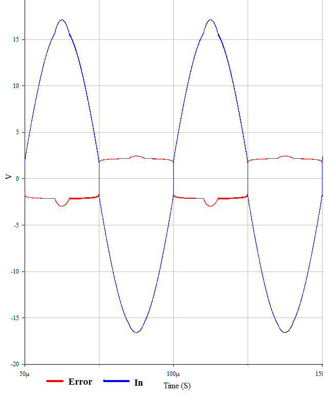

As might be expected, the error extracted increases dramatically, while the input to the complimentary buffer shows the great ''predistortion'' the correction loop has to generate to give a virtually distortionless output.
Note that if the output generates significant distortion, then sufficient headroom must be provided by the driver preceding the output stage to accommodate the potentially large ''predistorted'' waveform at its input.
