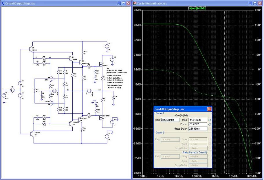

Attached is Andy_c's LTSpice model of Bob's output circuit. I have inserted a voltage signal generator V6 in the main feedback loop.
The voltage gain in any circuit loop can be measured by inserting a 0Vdc voltage source in a wire connection. A small ac signal is applied (small enough to avoid undesirable large signal effects at any point in the circuit). The ratio of voltage at the + end of the source to that at the - end is the loop gain x -1.
For V6 I chose 1uV ac. You can see from the graph that the loop gain is about 41dB up to a knee at 30kHz. The unity-gain frequency is 3MHz with a phase margin of 88 degrees.
Andy has used 724 ohm resistors for the "S2" summers. Bob's paper shows 680 ohms. With 680 ohm resistors the loop gain drops to about 22dB. I would guess the real circuit to be optimum somewhere between these two...the stability margin of the real circuit will be smaller because the simulation does not include inductance and psu impedance and so on.
This is reassuringly consistent with post #743 where Bob measured a 30dB improvement in the real circuits THD performance with the feedback correction applied.
I am going to adjust the S2 resistors to give a loop gain of 30dB to match the real circuit result and then measure other performance parameters of the stage.
Bob, can you confirm the transistor types you used in the real circuit and the resistor values?

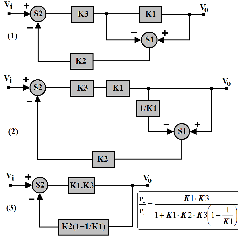

Pete B.
Having demonstrated the general criteria for error cancellation in respect of an output stage with an arbitrary nominal gain K, an even more general solution may be obtained by simple manipulation.
From this it is clear that this is a simple negative feedback system, subject to certain conditions.
Discuss.
As jcx mentioned before, my sim contains an error. It's missing a ".options plotwinsize=0" directive. This directive disables the data compression that degrades the accuracy of the distortion sim.
For AC analysis, the voltage amplitude is not relevant except for scaling of displayed data. For AC analysis, SPICE replaces all nonlinear devices by their linear equivalent circuits, making 1V a nice convenient value to use for injected voltages.
Also, I basically pulled the device types out of a hat for this sim :).
For determining the depth of the null, the distortion sim should work well, but it needs the ".options plotwinsize=0". Of course, when you change collector resistor values, you'll need to rebias for 150 mA output stage current.
In Hawksford's equations for the component values of his error correction circuit, he neglected the effect of the error correction transistor re. I think that's why I changed the collector resistor value back when I originally set the sim up. One possible thing to try might be replacing the error correction transistors by CFPs. This will eliminate the re contribution, so a smaller collector resistor would be required for a null.
Andy, you can always insert 150mA CCSs in series with each FET source, each one bypassed with a huge cap, like 1F, to avoid having to keep iterating the bias resistor.
Hopefully Bob will provide the authentic part values. Meanwhile your model is fine for getting the right "ball park" estimate of the shape of the loop gain vs f and for exploring how the circuit works. If you do a distortion measurement with and without the feedback connected you ought to find the distortion ratio is pretty close to the feedback ratio.
Interesting idea. We can also take a look at why Bob added that extra NFB path from the gates. I think it is just a convenience for biasing the FETs but is not strictly a la Hawksford either.
