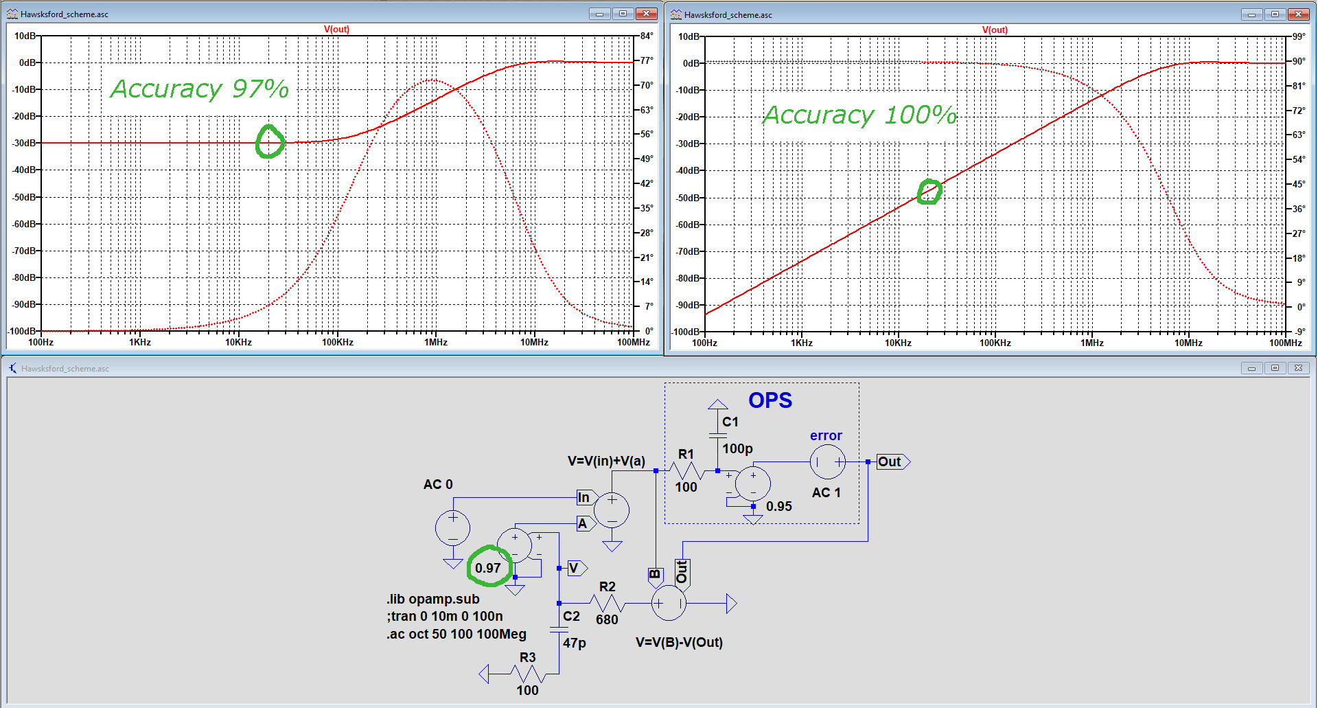

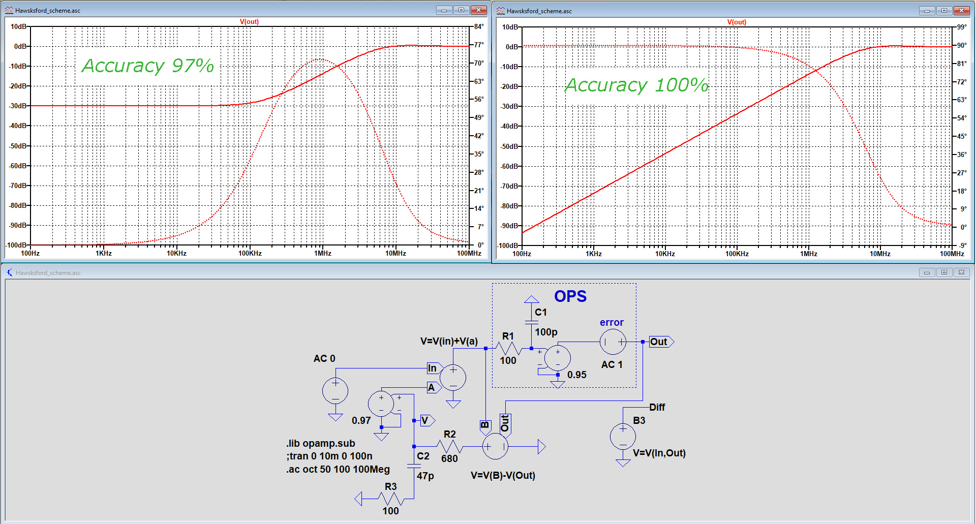

What I was trying to say is that from a practical point of view, AEF is to be preferred over HEC, because you need no tuning.
To say that 3% resistors are o.k. means that you first have to find the 0% point.
Using 3% resistors means a 30dB error correction over the audio range, see left image below.
THD20 could theoretically even be reduced by 45dB when having used a 0.3% resistors, see second image at the right for 0% resistors.
When using AEF, you will theoretically get the distortion reduction as in the image at the right without any trimming at all going down all the way down, ending at the OL gain of the amplifying path used.

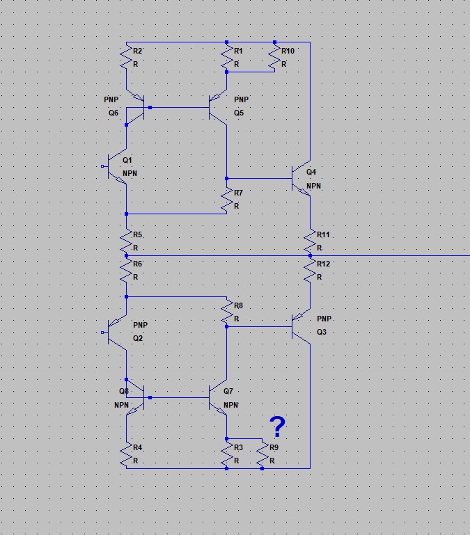

Jan,
We can agree to disagree, see my posting one step back.
As you see in the circuit diagram, there is no gain involved.
As I said earlier, this was the geniality of Hawksford's invention, that with a gain of exactly 1 you could get a perfect error cancellation.
Hans

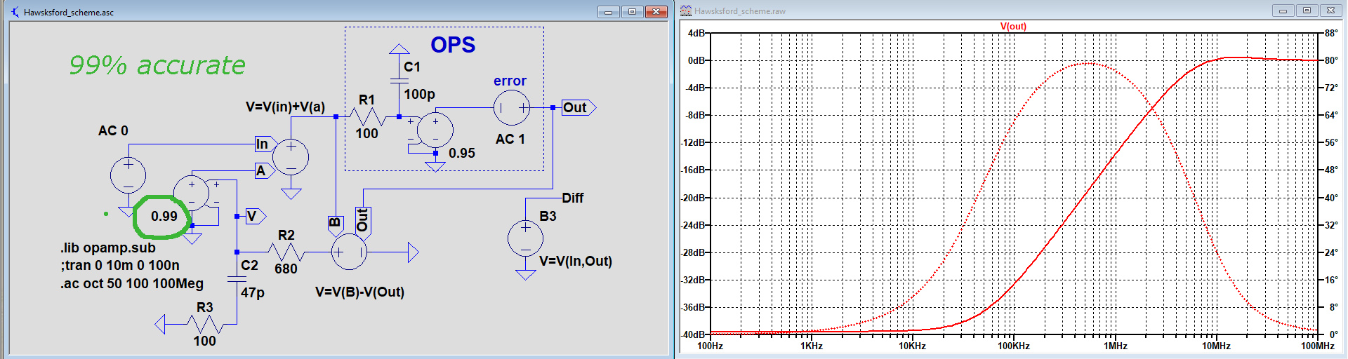

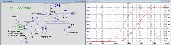

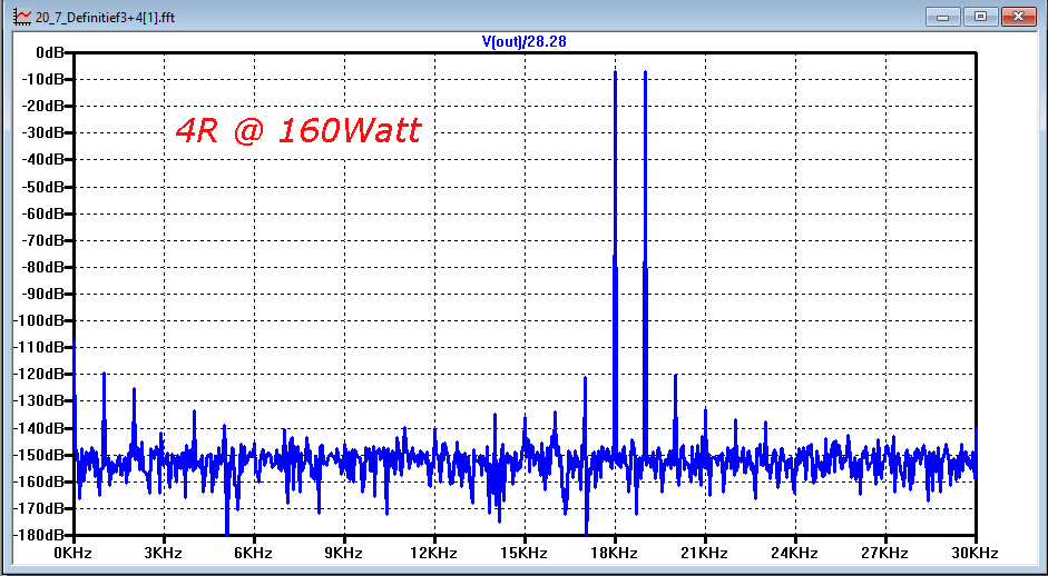

Jan, here you are with 1% resistors.
Hans
Nice. As expected. I love it when it all comes together ;-)
Jan

No, I have never built this "AEF" amp. The only reason I simmed this amp is to shed another light on HEC and to "prove" that HEC is equivalent to an output stage with a large amount of negative feedback.
To all,
One can find the schematic here and a slightly improved version here.

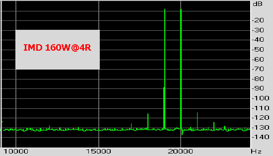

Hi Hans,
Do you have THD-20 measurements for that amp?
Bob

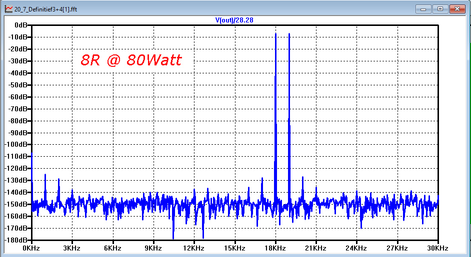

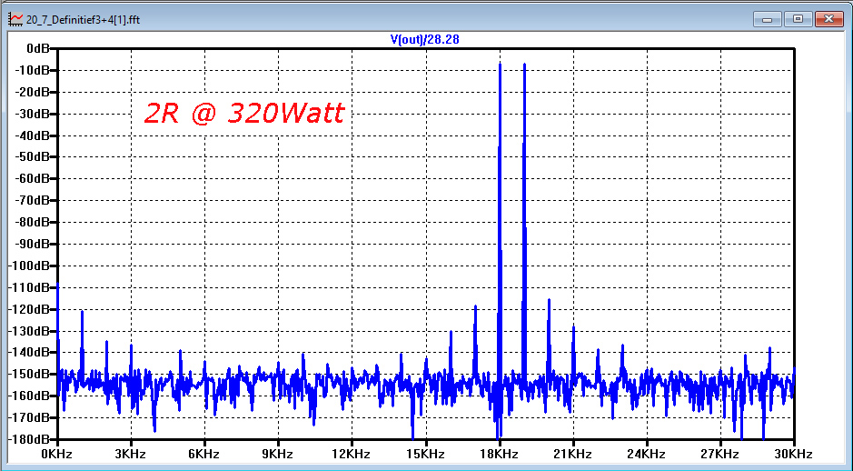

THD-20 figures without AEF are:
For 8R load
0.035% at 80Watt
0.040% at 100Watt
For 4R load
0.41% for 160Watt
0.46% for 200Watt
I had to use the existing bipolar 3 EF endstage of my ML20.6, but the IMD figure at 160Warr@4R below shows the effectiveness of the AEF.
Hans

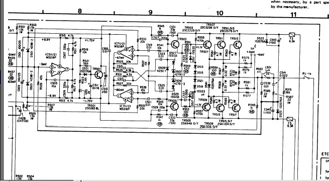

How works DENON's Error Correction from the Models PMA900V and PMA700V ?
check out post #22 under
about the Denon PMA-700 amp.
The mentioned attachments I had also upload here

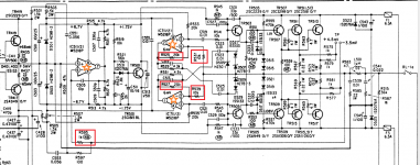

I couldn't understand this DENON's error correction circuit but currently in my understanding, it is detecting voltage drop of the output stage by the gain of 2 differential amplifiers and adding them from R531 4.3kΩ and R545 + R515//R513//R511//R517 ≒2.2kΩ which forms about 1/2 of gain , thus combing opamp stage,
gain of 1 is achieved. In fact it have PFB through R547 but I could not understand the operation.
From understanding the HEC is PFB+NFB, why does Denon have two feedback amplifiers? It may be better to be classified non switching circuit combined with D511-D517, rather than error correction.
I think the schematic has errors or a revision around IC511, it must use dedicated opamps for each channel.
The opamp basically a typical feedback gain of unity, with the feed-forward path from +input to supply pin, which is the reference node of 2nd stage of the opamp circuit. (miller compensation stage) Unity gain feedback plus feed-forward to supply pin have multiple benefits that are
more linear input stage because it doesn't need to charge miller comp cap why 2nd stage is on floating at almost equal voltage to the output voltage.
input stage has fixed VCE like bootstrapped-cascode.
greater bandwidth by bypassing the input stage.
The bandwidth may help multiple feedback amplifier -AEF type circuits in the thread.
The circuit topology hans posted have a feed-forward path but it does not always exist in multiple feedback circuits.
