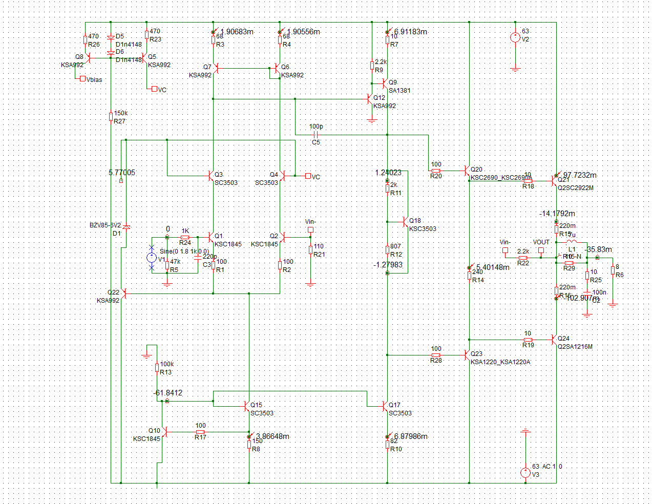

Hi
I have run the circuit in Cadence using factory models; I have included the models I’m using in a text file.
I had to change some resistor values and the Voffset, but otherwise the circuit is the same.
I have included the schematic, the schematic with currents, the 1k sinus spectrum, 20k sinus spectrum, AC open loop and AC closed loop in pdf files.

What am I doing wrong?
If this circuit is a ppm thing in LTspice, I will change to LTspice immediately (designing very low “ppb” circuits)

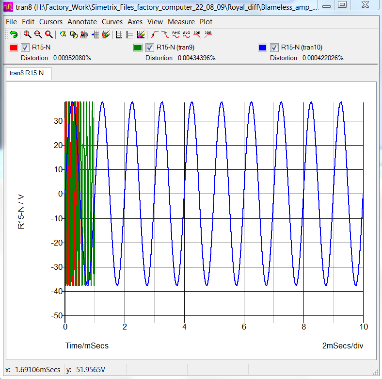

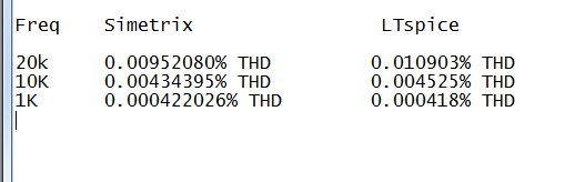

THD simulations using simetrix compared to LTspice
Here are the results I got comparing Simetrix with LTspice simulators

Simulators
From the above results you can see that Simetrix and Ltspice in terms of THD simulation give similar results so it is fair to say Ltspice is good for THD simulations provided you have good models.
For your Simetrix, the standard errors ref. LTSPICE are:
1KHz - 0.96%
10KHz - 4%
20KHz - 12.67%
Set aside the strange error vs. frequency distribution (intuitively, I would expect errors to be larger at lower frequencies, where THD is lower), I wouldn't call a 13% difference "similar results", but more like "in the same ballpark".

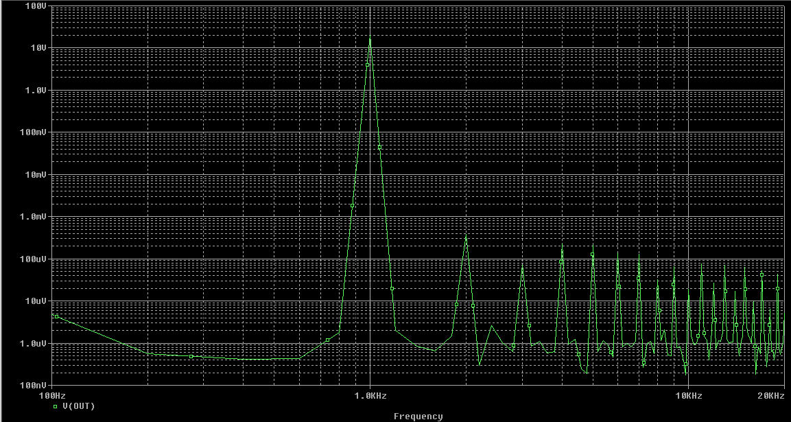

Can someone tell me if the spectrum peaks, for example the comparisons shown on post 3829, are the supposed to be the same as the individual .FOUR tabulated components (I dont think there is any power relationship I'm missing)?
I find it interesting that the spectrum peaks for the Orcad simulation appear to line up very well with the LTSPICE tabulated components (referring to post 3829).
I mention this because I thought that for the frequency plot Orcad did an FFT over the entire interval of the time data, whereas the .FOUR uses only the last cycle with some specialized way to calculate these components.
-Antonio
-Antonio

Cadence
Hi Stein,
You are the second one who got erroneous results from Cadence.
Whether you are doing something wrong or you should blame Cadence, I don't know yet. Perhaps, you might ask syn08 (AFAIK he's also using the Cadence simulator) to repeat the sim and confirm your results.
If time allows, you also might sim the original and optimized 'blameless' amp, that is, with a LTP tail current of 6mA, LTP degen. Rs of 100 Ohms,
a decent current mirror and Cdom = 100pF. Now, THD @ 1kHz should around 10ppm. This value has been measured by D.S. himself.
