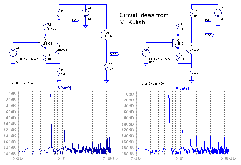

Another error-corrected circuit
It was published in December issue of Russian magazine "Radio" in 2005 by Michael Kulish. I have got that article in DJVU format however it is in Russian . I've just posted in another thread results of a simulation of one of the circuits described in that article and than thought about posting it here. I hope I would not be punished for a little cross-posting as it seems appropriate. If it is not, I apologise.
I know that the author of this idea is member of DiyAudio, however I can not find him at the moment as I forgot his nickname at the forum .
Here it goes:
Cheers
Alex
P.S. - there is no feedback in this circuit except local... correction is done by summing two currents and in the article the author describes a full-blown and fully symmetrical VAS with this kind of correction.
P.P.S - the FFT graphs are for 1 V RMS output at 10 kHz, the gain is about 9 dB

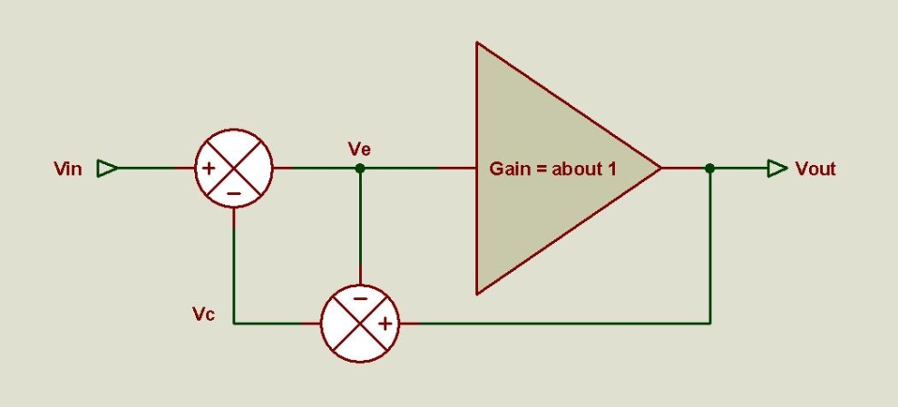

Bob Cordell said:Hi Edmond,
I think that both ways of looking at EC are valid and necessary, as each has its value in exposing the behavior of the approach.
Even if it is viewed as nothing more than a negative feedback loop inside of which we put a unity gain positive feedback loop to get theoretically infinite forward gain, the technique is extremely effective and no more difficult to compensate than an ordinary feedback loop, if you know what you are doing, notwithstanding Charles' assertion that stability is a problem.
Part of its advantage comes from the fact that it is an extremely tight, fast feedback loop (or whatever) around the output stage.

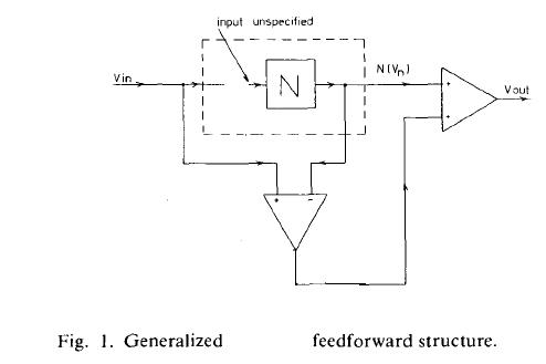

I scanned Jerry Graeme's article on generilized feedback models on my home page. It's faily large (6.5MB) so will take a few secs to download.
Using Graeme's method, the effective feedback factor of the ec output stage I posted above comes to 1/A-1, with an 'A' that is *about* 1. It's easy to see that if A would be exactly 1, (no distortion, no errors) there would effectively be no feedback at all. The farther A departs from the ideal '1', the more feedback we get, but only to the amount of the error, the difference between the actual 'A' and '1'. There is no main signal feedback, if you know what I mean.
If 'A' becomes more than '1', the feedback becomes negative as to reduce the closed loop gain. If 'A' becomes too small (smaller than '1'), the feedback becomes positive as to increase the cl gain to '1'. In each case, just the right amount is added/subtracted to the input signal to compensate for the loss or excess of A.
Now, where's this 'infinite gain' thing?

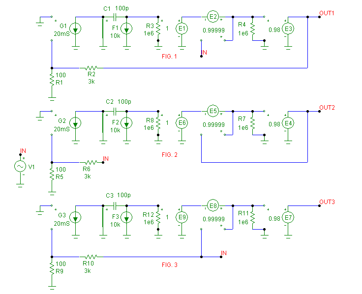

EC loop gain
I thought this IS Bob's EC thread, isn't it?
Hi Jan,
I have taken your advice to look at a complete circuit, that is, combined with negative feedback. Lacking a complete schematic of your design, I have made my own, although very basic: an input stage, VAS, unity gain buffer, EC unit and output stage. There are three versions of them, each with the loop broken at a different place.
See my next post for the gain-frequency response and further comments.

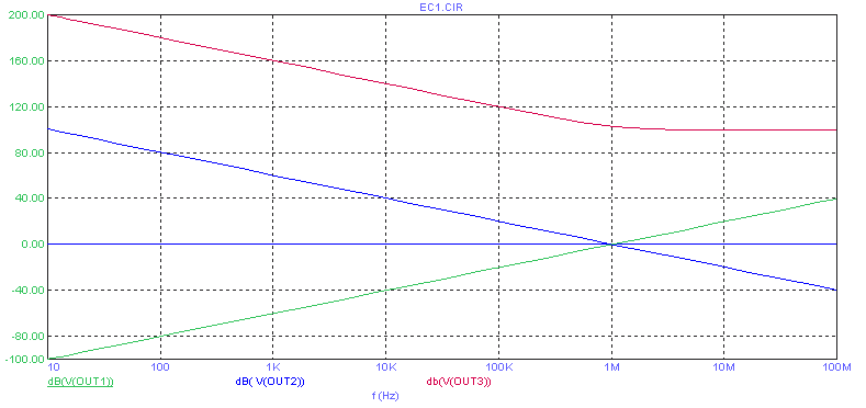

EC loop gain
(continuation from previous post)
The first one (green curve ) is just the loop gain of the EC circuit. At moderate frequencies the gain is very low, apparently, because all the "work" is done by the neg. FB loop. At around 10MHz, a frequency at which local instabilities might raise its head, the loop gain is much higher and implies that the EC circuit should have good HF properties.
The second one (blue curve) shows the global FB gain seen at the inverting input. Nothing special about it and (almost) the same without EC.
The third one (red curve) reveals a totally different behavior, an enormous loop gain, getting infinite if the gain of the EC stage itself set to exactly one (can't show this as my simulator makes objections)
So here is "this 'infinite gain' thing"
Cheers, Edmond.

Wow! Need to look at that.
A couple of questions first: what is the open loop gain of your circuits? I'm not very familiar with your particular implementation so this would help.
The (implicit) assumption in my circuit is that the open loop gain should be *about* the same as the required cl gain. If the ol gain is (much) higher, the circuit will tend to 100% feedback around the (very) high ol gain so that might be seen as a 'huge' loop gain. What you would see in such a case is just the ol gain. Since there would then be a quite large delta between ol and cl gain, of course that shows up as loop gain.
One of the nice things of ec is that you don't need large ol gain....
The RED curve is from fig 3/ output 3?
Jan Didden

Hi Jan,
I suppose you mean the gain at the non-inverting input with enabled EC and disabled global NFB (R6 disconnected in fig. 2).
Well very simple, generally, the gain of the NFB loop multiplied by 31 ( (R5+R6)/R6 ). So, about 70db at 10kHz.
janneman said:I'm not very familiar with your particular implementation so this would help.
Apparently you are not familiar with the typical MicroCap symbols, but this very basic implementation covers most of the specific implementations, including yours, although I have no knowledge about your front-end, and including Bob Cordell's version, except the frequency compensation by means of C2.

Look at OUT3.
Cheers, Edmond.
estuart said:
Hi Jan,
I'm sorry to say, but I agree with Charles. Theoretically, EC is nothing else than reducing the distortion to zero by means of a FB circuit with infinite gain. If you don't believe me, just break the loop from output to the node of R42 and R43 in Bob's example. You'll see a loop gain in the order of 40 to 50 dB. So, Charles isn't wrong, it is just a different point of view.
Cheers, Edmond.
