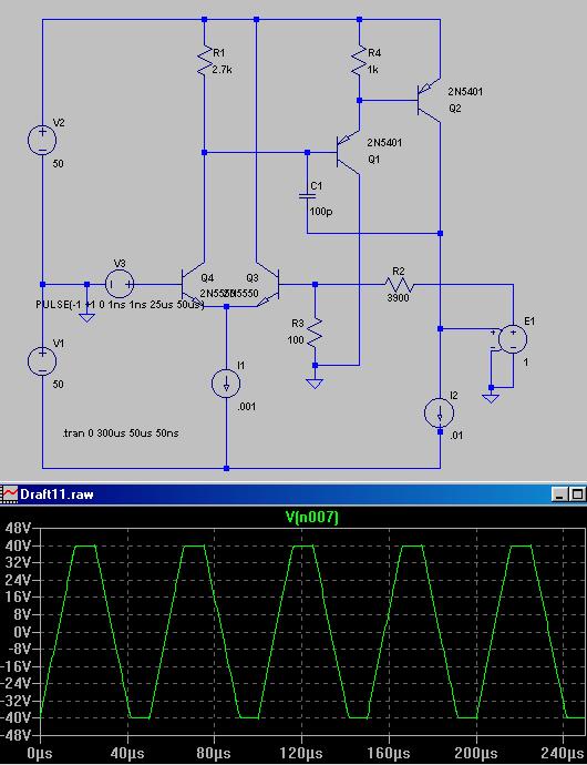

I’ll give you a practical example of a miller compensated amplifier that may very well measure OK, but sound better if the miller compensation capacitor is reduced in value after a little lead compensation is added.
Attached below is a simplified simulation schematic (using an ideal unity gain output stage) of an amplifier front end typical of many designs and by no means a worst case example.
The amp is rated at 100W into 8 ohms, so its peak output voltage swing at rated power is 40V.
The LTP is provided with simple resistive loading instead of a current mirror. The load resistor is valued at 2700 ohms and passes approximately 0.5mA with the buffered VAS biasing voltage across it.
In order to ensure current balance in the LTP, the LTP is given a tail current source of 1mA.
Cdom is typical at 100pF.
Because of the low tail current of the LTP to drive Cdom, this design only slews about 5.5V/us. The triangular waveform in the picture attached below is the amplifiers 20kHz squarewave response.
This amplifier can only just pass a full power 20kHz sinewave with out slewrate-limiting induced distortion.
Because of this, the amp may even measure quite OK in terms of THD-20 at full power, but any sufficiently fast and large transient in an audio signal will instantly overdrive the LTP and cause hard TIM and massive temporary distortion of the entire audio signal.
Miller compensation is fine, so long as you have a high enough LTP tail current to drive Cdom for a given power output.
Hi Glen,
True, but there is one more point: The input stage has to deliver all the current that goes through the Miller cap. In your example at full power and 20kHz, about 0.5mA. At this relative high current, the input stage will considerably contribute to distortion.
If the Miller cap is connected to the inverting input, this current will be much lower (10uA or so), resulting in far less distortion from the input stage.
Edmond.

Yes, and in line with what you said, I gave an practical example typical of many marginal designs out there that CAN conceivably benefit sonically from having a lower value Miller compensation capacitor fitted.
To say as a general rule that any Miller compensated amp will magically sound better if the Miller cap is reduced in value with the addition of lead compensation is bunkum.

Hi Edmond. I agree, but my example was a deliberately marginal design. In a proper Miller compensated amp in which the LTP has a high enough tail current to deliver a slew rate for a power bandwidth of, say, 200kHz or so, then the increase in HF input stage distortion caused by the miller cap loading will be generally next to negligible.
Slightly off topic: another bug of mine - declarations as to what is acceptable in terms of slewrate for power amplifiers without any mention of the relationship to power output and output voltage swing.
Glen
Glen,
As a rule of thumb I'm using the following formula to calculate the required minimum value of the tail current:
I=3×2×Pi×Cdom×f×Vp
Then at 40V output using 100pF Cdom at 20.000kHz signal we need at least 1.5mA. In practise I'm using somewhat more tail current for better transient-response and to increase slew-rate performance of the amplifier. In this case I'd operate the LTP even at 3mA.

Hi Andy.
I like 10:1 rules of thumb.
If we design an Miller compensated amplifier with enough LTP tail current for a power bandwidth of 200kHz instead of 20kHz, then we ensure that the slewrate is more than adequate for the given output voltage swing and that the increase in input stage distortion due to Cdom loading is also small.
In my circuit example above, this would require a LTP tail current of ~10mA, which may seem impractically large.
However, if we remove the simple load resistor and replace it with a current mirror, the full tail current is available for actively driving the Miller capacitance in both directions, so the slewrate doubles and the LTP tail current requirement drops down to 5mA.
