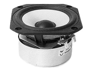

If only the sb65 was a little cheaper, I would do 30 a side of those...
I am leaning towards an oval cross section enclosure with a chamber for each driver and bending ply to skin the outside at present.
I have looked at schedule 40 pipe and aluminium box section, but both don't quite work with the tc9 frame.

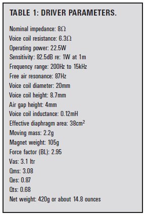

To my knowledge, the driver used in the IDS was the shielded Vifa 9BGS 119/8 which is no longer available except on special order.
It's definitely an 8 ohm driver in the IDS as confirmed by Roger Russell:
attachment.php
[excerpt from his article]
attachment.php
The Vifa 9BG 119/8 is probably the closest related driver available today. Also known as the Peerless TG9FD-10-08 ;). It still has this weird looking basket compared to the TC9.
The TC9 FD18-08 is also known as Viva 9BN 119/8 and Peerless FR35/8. Google searches on the related names give even more useful data ;). Sometimes the specs are all over the place like x-max. As far as I am aware most of these drivers have 2.55 or ~2.6 mm x-max (based on magnetic gap height/voice coil height) with x-mech being comfortably larger.

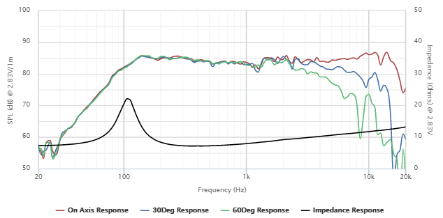

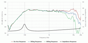

Here are copies of the graphs for the 8ohm and 4 ohm tg9 drivers, the first is the 8 ohm.
I think the 4 ohm looks nicer, but perhaps I am missing something...

Of those two graphs the 4ohm looks better, I actually think that the TC9 holds it's own by the look of the graphs. If you can get the TG9 at the same price or close to and you like the look of the cone go for it. I can't see much of a difference to warrant picking one over the other besides price and looks.
