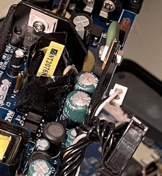

Bluesound Node2 PSU repair
My bluesound Node2 is dead with a steady red light on the LED.
Internet search identifies this as eithers a failed software update or a dead PSU.
Inspection shows the usual suspects C11/C12 bulging. The originals are 1.000uF/10 volt.
Unfortunately I don't have any of them, but I do have Long-life, 105º, 1.000uF/6,3 volt.
Does anyone know the actual voltage across these capacitors and if I can get away with 6.3V?
Picture beolow is from internet, but show the same damage on the aptly named capacitors squeezed between the heatsink and SMPS transformer
