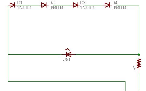

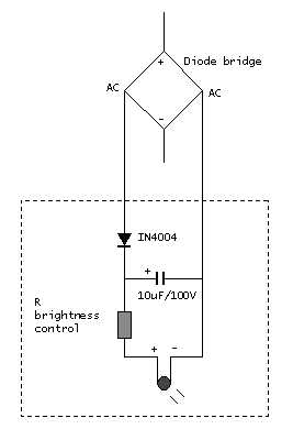

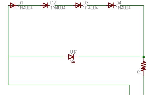

At 60Hz the capacitor reactance is about 5650 ohms which means about 10mA avg current corresponding to 1/10 watt dissipation in the 1K resistor (at steady state). There is going to be an inrush current initially and, I think, 1/2 to 1 watt should do it.
Capacitor charge is still there when you power-off. So you shouldn't offer yourself as a conductive path. ...
You should be very careful, always, when dealing with line voltages.
JAG -
Thank you. I feel a lot better now. I have imbedded your LED design into my amp. I used .47uF with four 1W 1K metal oxide resistors (to build 2W 1K resistor. I couldn't find 1K high wattage resistors in my box)
It lits up my room pretty good. It was kinda weird having a blue spotlight, but I now found it quite soothing.
Tomo
