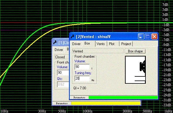

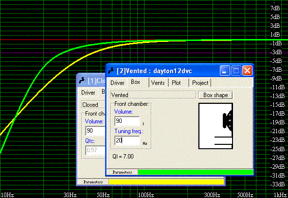

http://adireaudio.com/diy_audio/drivers/adire/shiva.htm
or
http://www.partsexpress.com/pe/pshowdetl.cfm?&PartNumber=295-185&DID=7
Parameters are remarkably similar, with a 3Cuft box you'll
get a low Q (~0.6) alignment, alternatively reflexing will
give more low bass and low bass SPL capability.
(A whopping 12dB extra SPL capability at 20Hz)
:) sreten.
